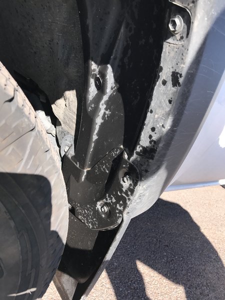

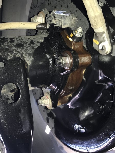

    I just noticed today that there was oil splatter on my diver's side rear wheel well. Once I climbed under the truck there appeared to be oil leaking from the rear of the brake. It's not brake fluid so I assume it's the rear axle seal. I have a appointment at the dealership in two weeks. Since this is a 2017 double cab off road with 4K miles it better be covered under warranty.

    TireFire

    Yes

    Yup

    The leak could be caused by a bad axle bearing. The bearing goes bad and the room for movement takes out the seal. The howl could be the bearing..
    I would put some tape over the holes in the control arm like the dude said and then if you still got a howl..

    The dealership fixed the axle seal, a blown shock (weird), and did the transmission TSB. They said they couldn't replicate the howl. It was all covered under warranty but it took 12 days to get it in to service.

    When my axel seals went I had to replace rear brake shoes as well, hopefully Toyota dealer didn't cheap out and re use your saturated shoes.
    My seal leak was caused by diff breather being clogged, but yours is basically new so shouldn't be clogged, something to think about in the future however.

    All work was done for no charge under warranty. That's a good point about a clogged diff breather. I remember seeing a mod for that. I'm fairly certain the brake pads were changed as well. I don't have the paperwork in front of me since I'm over seas right now.
