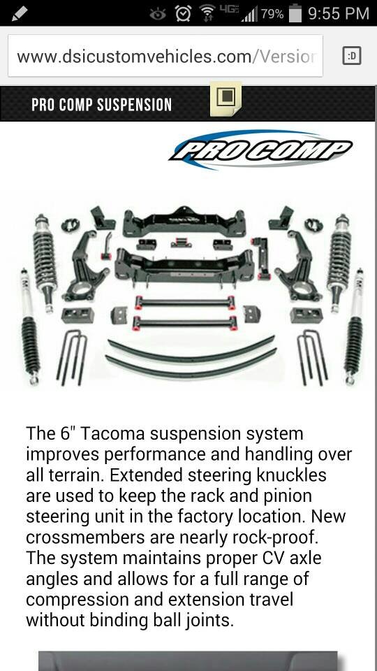

    Do you want offroad performance or just tire clearance? That lift is for the latter.

    Ya if you want off road the DB in that kit actually hangs lower than a 3 inch

    This is mostly for the street. ..not much off road

    Just street youll be fine

    Then that lift could be for you. It's 6", so you can clear 35s. You'll want to regear.
    It seems like many prefer the quality of Fabtech over Pro Comp for DB lifts. I'd do some more research before buying.

    DB?...school me

    DROP BRACKET
    you cut the factory cross member then install that which drops the front diff to keep the factory CV angles

    It's less Tacoma and more mod
    Drop bracket, for the front LCA (lower carrier arm)

    Yea want fabtech but the procomp is dealer approved on a new 2015 and they stand by the factory warranty when installed with a package

    NO SUSPENSION LIFT VOIDS WARRANTY, only a Body lift which is dd to me, I asked when I bought mine

    Not true when done through a company called dsi

    Wait... Are you 2wd or 4wd?

    4wd...yes they cut the crossmember

    Dealer services international, pretty sure its all associated with 4wheelparts/pro comp.
    So no chance of getting the fabtech?
