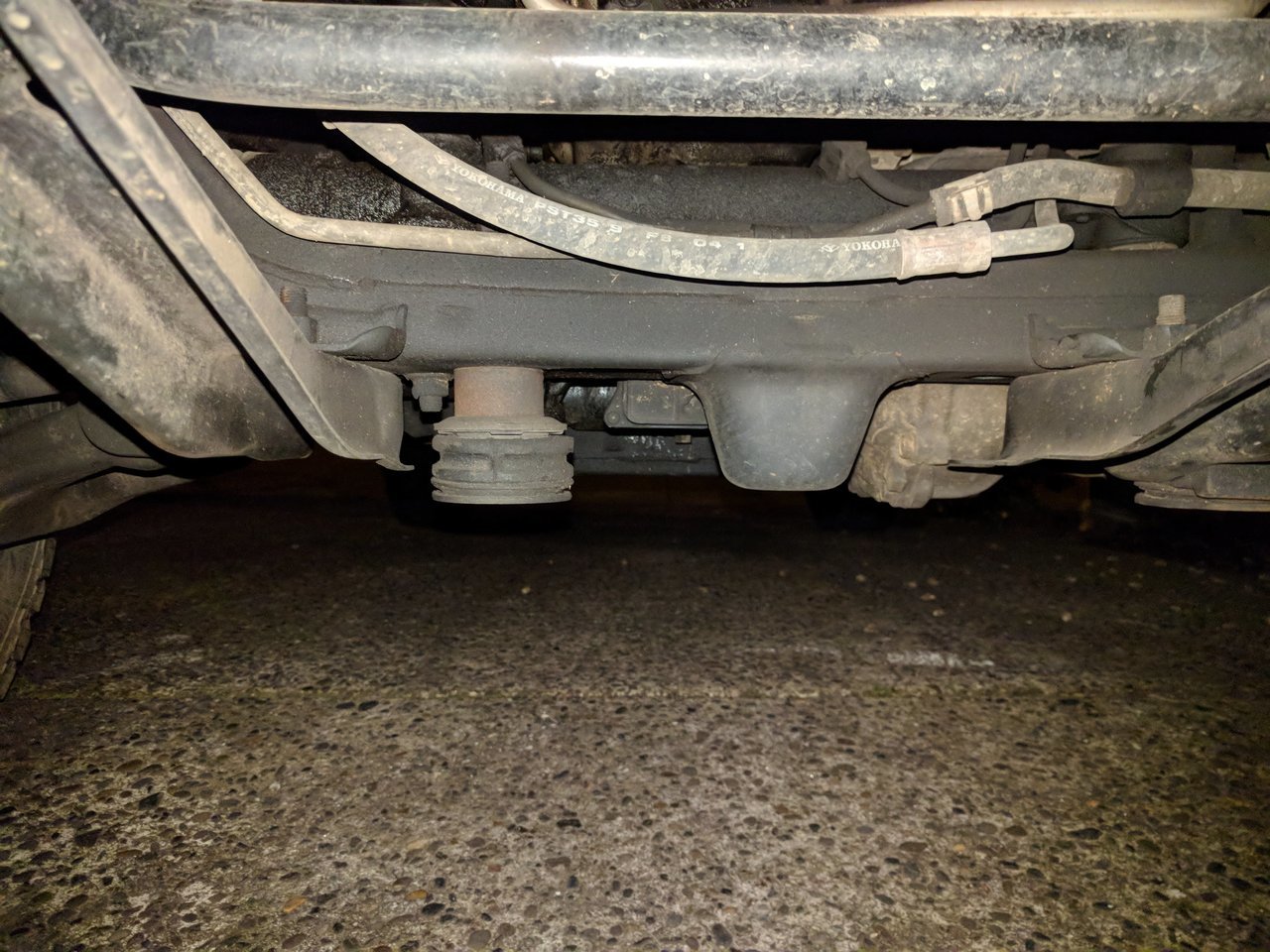

    I noticed most users have their tacoma's no. front differential support w/o a gap.
    Not sure what I have on mine, or is this loose?? I'm replacing wheel bearings soon, but was curious about this gap that's on both sides.
    Looks like a diff drop from? Link to post

    Looks like a homemade spacer diff drop yeah. I dropped mine 3/4" simply because I was in there and I happened to have aluminum pucks already, however on a second gen Tacoma it's said it's not necessary.
    If you have lift vibes then you need to replace the needle bearing with the solid sleeve bushing from ECGS.

    Thanks! Yikes homemade. I hope its alright.
    I don't think I'm getting any lift vibes, but driving on the roads I can feel every bump. I'm ordering wheel bearings soon. Is that needle bearing in that assembly or different? Couldn't quite tell from diagrams.

    Definitely not in the wheel bearing assembly, it sits inside the spider gear case inside the differential housing, you have to remove the CV axle on the left side to get to it, and then it requires a special puller tool to remove.
    If you're feeling every dime on the road might be time for shocks and springs not wheel bearings unless that's a separate issue.

    Get rid of those spacers
