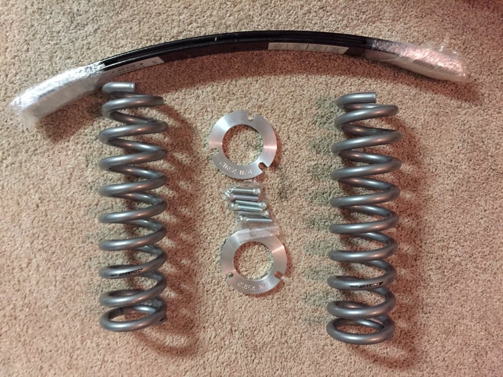

    I ordered this exact kit from ToyTec for my 2015 DCSB TRD OR, and it arrived today actually.
    Kevin at ToyTec assured me it would be a decent quality lift for the price (better performance than puck spacer type) and it would align just fine with stock UCAs. We also talked about shock choice as I plan to leave the factory Bilsteins on with this kit. Kevin mentioned that the difference in down-travel between a 5100 and yellow/blue Bilstein would be marginal.

    They actually are just rebranded Eibach coils, but the 2.5" "heavy duty" 521600 instead of the 1.5" Eibach coils
    Either way, ToyTec says they'll do fine UCAs or not
    However, I am on the fence about going ahead and doing 5100s set at 0.0 with the Eibach 2.5" coils and 1/2" top plate spacers...

    ~2.5" in the front, nothing in the back, only the front provides lift by moving the coil perch.
