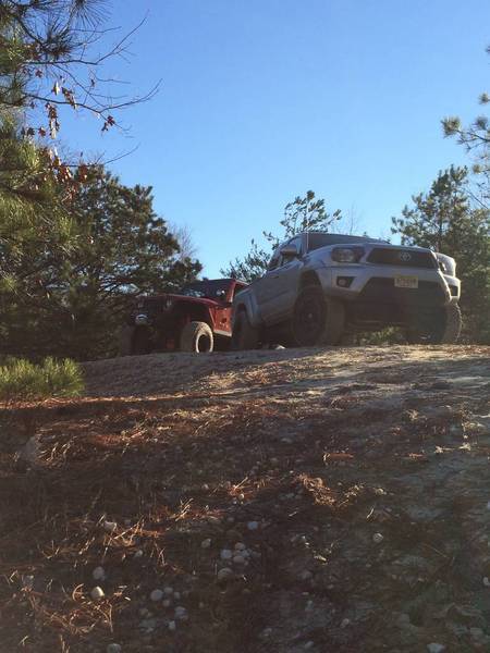

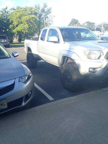

    Bilstein 5100's set at .85, OME 885x coils w/ 1/2" top plate spacers, Total Chaos UCA's, Wheelers 1.5" HD 3 leaf progressive AAL w/ factory overload leaf, DT Pipe Bomb Ypipe, Vibrant resonator, Magnaflow pro series catback system, URD Short Throw Shift Kit, Debadged, BHLM, BTLM, 6000K BiXenon Headlights & Fogs.
    Hey OP, things like this are tough because everyone has different preferences on ride quality. Some people can throw spacers and blocks under a 30k$ truck and be perfectly happy, and some arent satisfied until it has full fox coilovers. I can only comment on what I know, so heres what i got.
    I went with the 5100's on all 4 corners as mentioned before, a very popular option on this site. Front adjustables set to 2.5" on stock coils and stock uca's. For the rear i went with the wheelers offroad 1.5" HD 3 leaf progressive Add a leafs. I also left in the factory overload leaf in the rear. They make that kit in HD and non HD. I got what i did because i tow alot. With this setup I got 2.5" in the front and about 2.25" from the rear. Paired with some 33's and im happy. I wanted the full 3" in the front but that extra 0.5" seems to open a whole new can of worms and $. New UCA's, and the possibility of driveline vibes. I have an old school alignment shop near my house that gave me a good quality alignment and ive had no issues with the stock uca's at that height. I cant comment on how my own truck rides but numerous people that have rode with me have commented on how it rides like a car and better than the typical "lifted truck". So far 1 year and 30,000 miles ive had no issues, granted i dont wheel it hard, i just get to fishing spot and trail ride.
    Heres a pic to see how it sits
    Good luck with whatever you buy.
