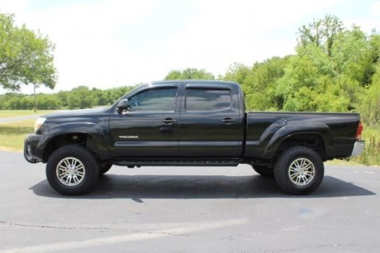

    2005 Double Cab Long Bed V6 AT 4x4 SR5 with 3" lift
    I traded in my Prerunner for a 4x4. The new-to-me Tacoma has aftermarket wheels which I don't really like. I think they're MB Motorsports or something. They're chrome and I want to go with black. The tires on the wheels have some life left in them. Cooper Discoverer 265/70R16.
    Here's what I want to do. Buy XD Addict 16x9 -12 offset wheels in black. Switch the tires on to these wheels and sell other wheels on craigslist. Will going with a 16 inch wheel limit my choice of tires in the future? Will there be anything that I regret about getting 16's? Later on, I will upgrade tires once the tread on these are gone.
    BTW, the truck has a Toytec 3" lift on it. It's a DCLB V6 SR5.
    Am I being super picky by wanting to replace these wheels with black XD Addicts?

    It's your truck, you should do what you want. Sticking with 16" will limit your choices later on, seems like there are a lot more choices in the 17" range, but that is not to say there are not good tires out there in the 16" size. if you are wanting to go bigger it may limit your choices. I prefer the ride and look of the bigger wheels personally. Bottom line is figure out what size and type of tire you want and look to see if it comes in a 16" wheel size.

    You won't be able to get 35s but there are 33s that fit a 16" rim.

    I was inspired to stick with 16's based on a truck which is a lot like vandaltaco's rig which I think is riding on duratrac 285/75R16 tires. Of course, my current tires won't look nearly that nice.
    But what I'm hearing is that the main down side to 16" rims is that I won't find 35" tires. But I can find those on 17" rims.

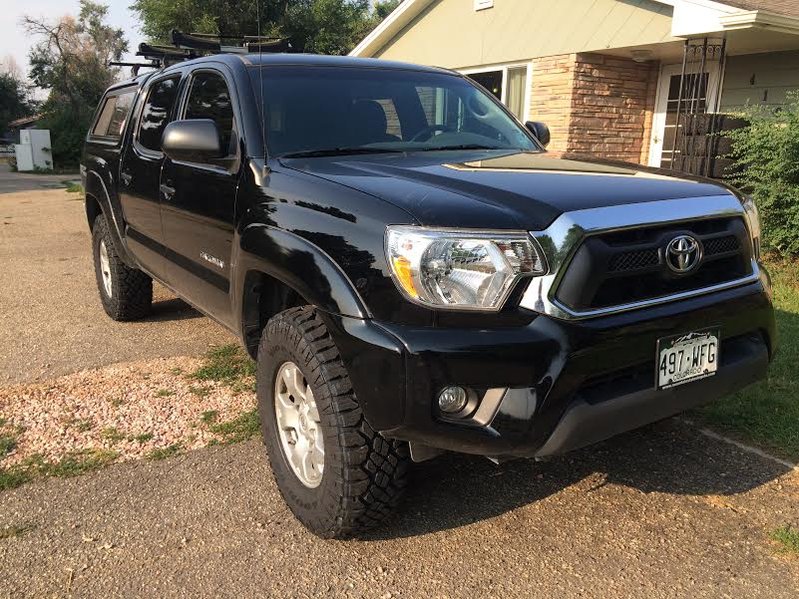

    Ride height and speedo difference will be due to overall tire height, not wheel size - just in case anyone was unclear... Lots of choices in 16". I prefer more rubber, less rim personally. You get more squish when aired down too.
    MadDaddy and Island Cruiser like this.

    265/75/16 Wrangler Duratracs 3" Bilstein Adjustable suspension lift 16" Pro Comp 7032 wheels Leer cap Thule cross bars Thule SUP rack Weather Tech Liners Front match window tint
    I just threw the 265/75/16 Duratracs on my stock TRD off road wheels, and I love the way it turned out.
    MadDaddy, EDDO and haskell[OP] like this.

    I like that. Any fitment issues / rubbing? Any change in fuel economy? Any noticeable loss in power?
  19. Aug 21, 2015 at 8:52 AM
    #19
    psk52987
    psk52987 Member
    Sep 10, 2014
    #138003
    14
    Pat
    Colorado
    2014 Tacoma TRD Off-road
    Nope, no rubbing at all. I searched for awhile seeing what the largest I could put on without having to trim or without rubbing. I had Duratracs on my old tahoe and loved them. They are great tires.
    A lot better than the shitty Rugged Trails that come stock on 2014 Tacos. Very happy with these.
