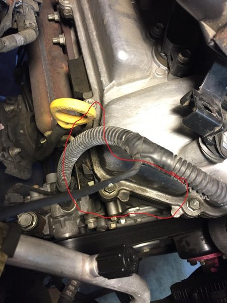

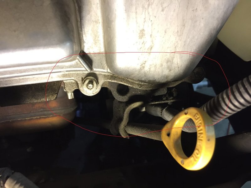

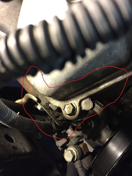

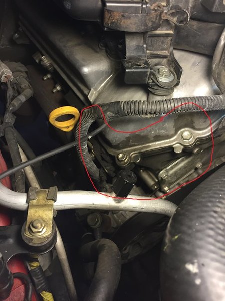

    While I was flushing my fluids I noticed this, I do not know the terminology to explain what the dirt is on... Here are some picture, does anyone know what this is or why it might be leaking? Can it be fixed? Thanks in advance for any help.

    Is there any oil on side of motor also is your motor low on oil?
    If not than i wouldn't worry about it.

    I do believe I have seen elsewhere on this site that this is the common spot for a bad gasket. so yes, in my opinion its a small or very small leak.

    I have the exact same oil stain, I noticed it at 30k when doing my plugs I wiped it clean and now at almost 100k it looks the same as it did at 30. I wouldn't worry about it unless your have oil running down the engine IMO

    There is no oil running down and below that there is not to much dirt... Cleaning of he engine bay is up next! Thank you all very much for the comments. Have a good one guys.

    2013 NBM AC 4.0 4x4 Auto OR
    since
    that is near the dipstick
    and the dipstick tube is dirty
    and the oil is not fresh
    I am saying that is
    just spilled oil from checking the dipstick.

    My Truck has those same spots. I think the tacoma head gaskets commonly leak in those spots. I wouldn't worry about it, just check your oil periodically to make sure you aren't losing a significant amount. It shouldn't be a problem until it starts leaking more
