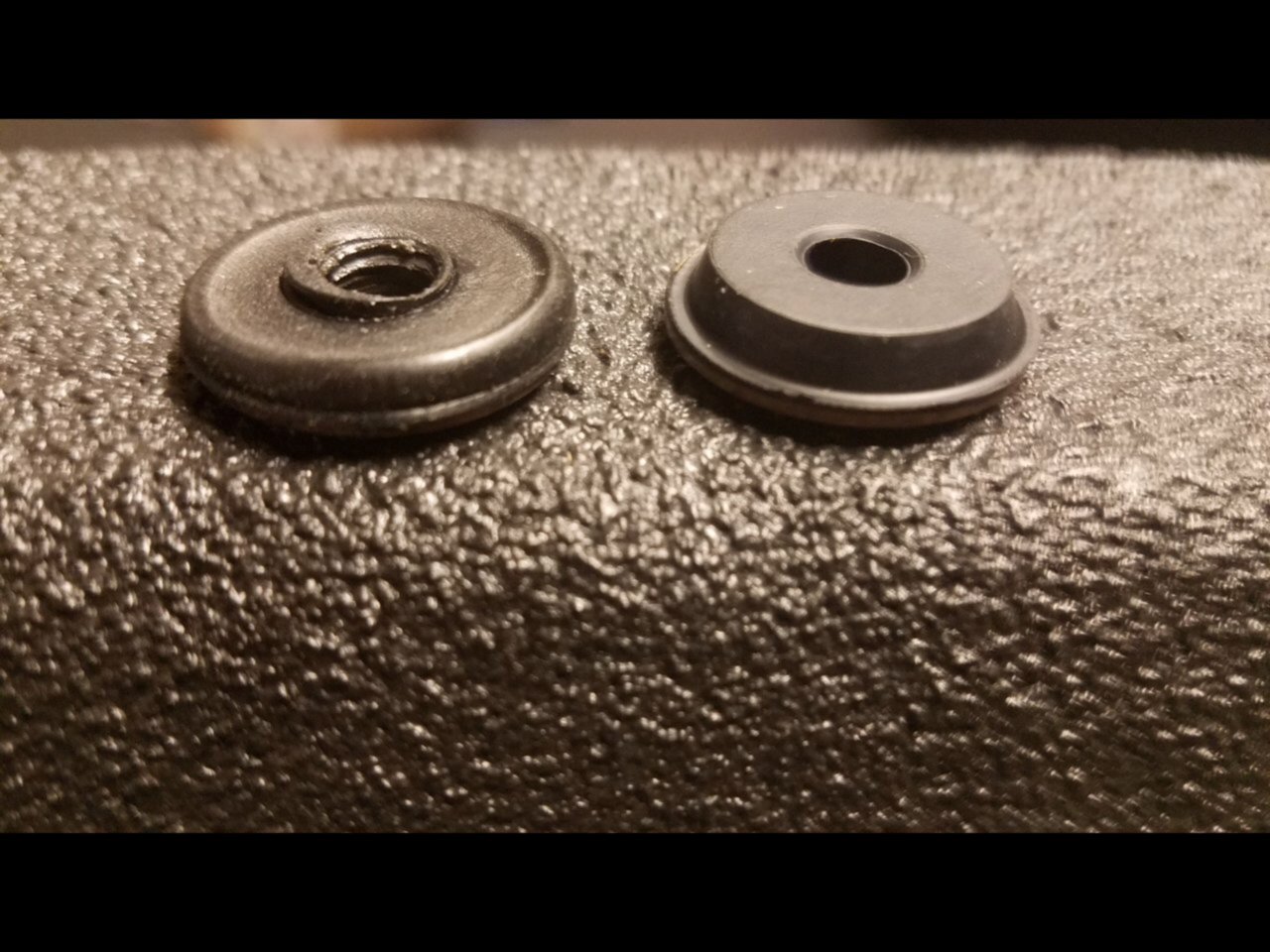

    AND the washers too,
    This is what a new one looks like and an old one,
    No wonder why the bolts get loose
    cruxofthebisquit and GQ7227 like this.
