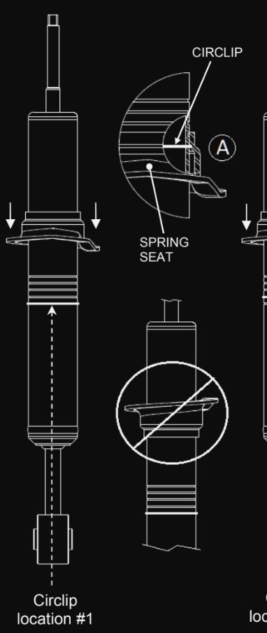

  12. Nov 17, 2022 at 7:22 AM
    tonered
    tonered bartheloni
    Sep 25, 2017
    #231055
    31,267
    tony
    Lynnwood, WA
    Is the lower spring seat installed upside down?
    jsinnard, thomasburk and eurowner like this.

    Bishop84 Well-Known Member
    Dec 17, 2015
    #172494
    12,021
    Also its possible they used the lifted coils on the 5100s? Any perch height with lifted coils will ride like poop.
