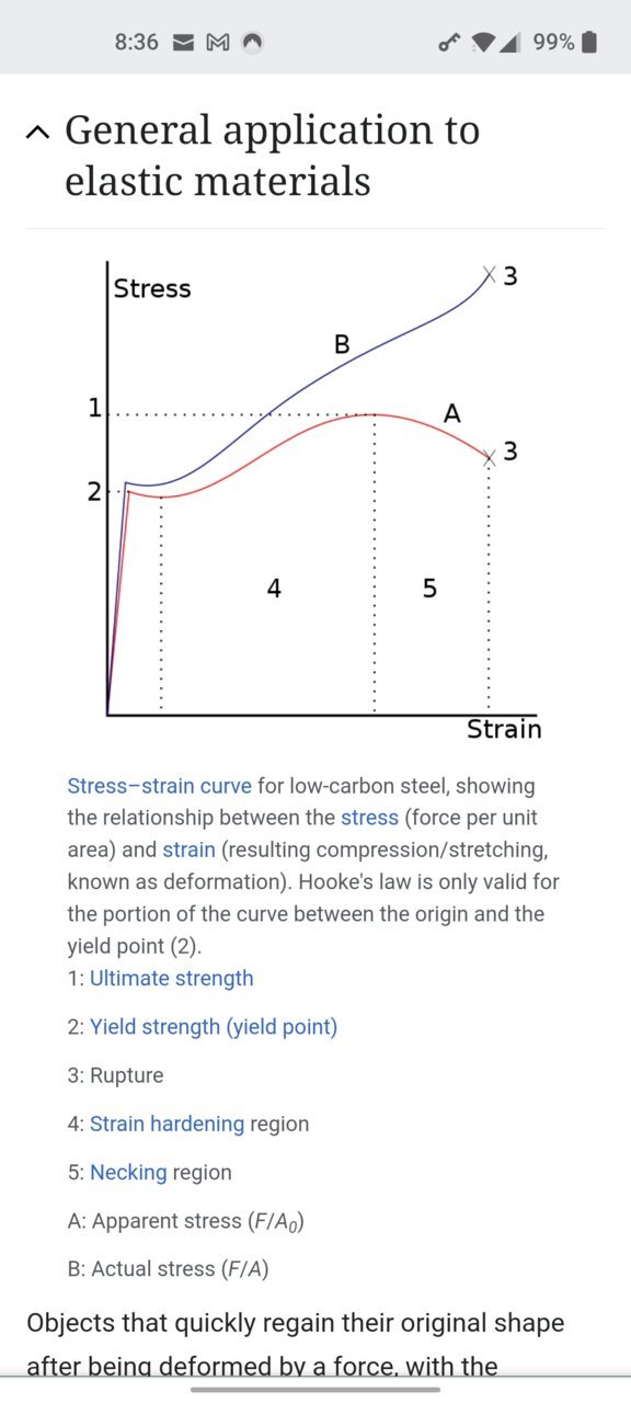

    I think we are saying the same thing with different words. This graph from the same page sums up my point. I have probably been using "spring rate" incorrectly, though I understand it is a fixed material property. I'm trying to describe it in a practical sense, which I think this graph does.

    I don't see how that diagram is applicable. Under normal circumstances, an automobile suspension spring operates well below its yield strength (in the range where Hooke's Law is a good approximation).

    I'm definitely not suggesting we go into plastic deformation. My position is that adding preload starts you at a higher "effective spring rate." Let's say you start with strain X and you need stress Y, to get there. Now add some preload and start with 2X strain. You need 2Y stress to get there given the linear relationship. To gain more strain (compression) while going down the road hitting bumps, you need more then 2Y stress to have any suspension compression. With our lesser preloaded example of stress Y, you still have the strain range X through 2X to move through, which is done with less than 2Y stress.
    Point is just that it takes more force to compress a spring beyond a given point then it took to get to that point, but yes the relationship is constant/linear, but with preload added you are starting further down that road of needing more force for further compression. Rates always screw me up...meters per second, per second and all...
