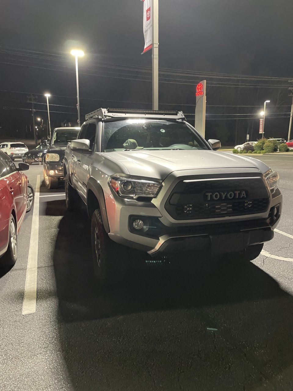

    Well boys,
    She’s in Toyota’s hands now. 58,650 on the ODO, paying full for the full diag
    Tires rotated, inspected, 80% left on them. Alignment done, no fluids leaking. Suspension checks out (inspected by shop that installed). CV’s look good, so… here’s to crossing our fingers for some good news.
    I’m looking forward to Identifying the issue, and resolving it.
    I’m almost certain the transmission is the root cause. Just paying attention to the shudder, how everything seems to “lose power” (not electrical) in fourth or so gear. Then it shudders until I give it gas.
    Here’s to hoping.
