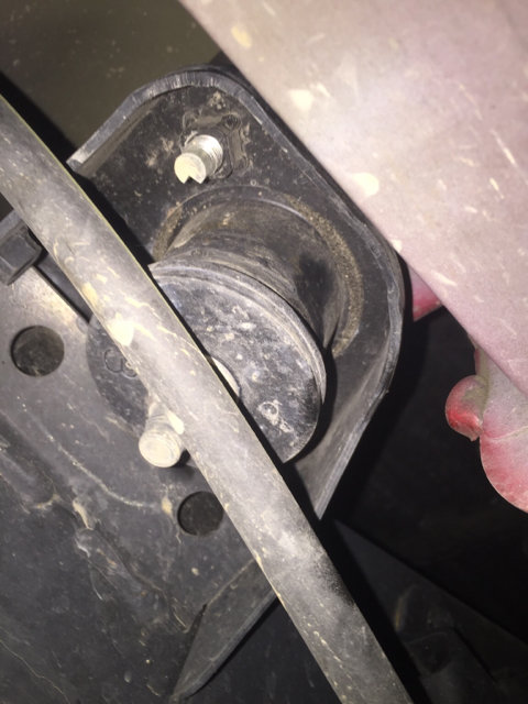

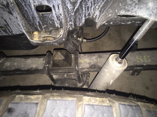

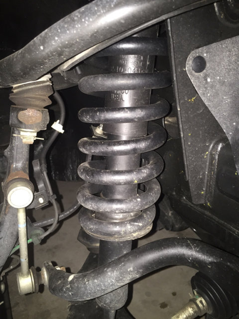

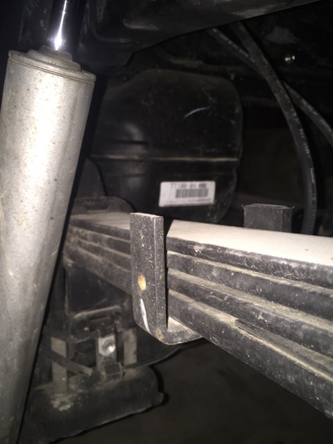

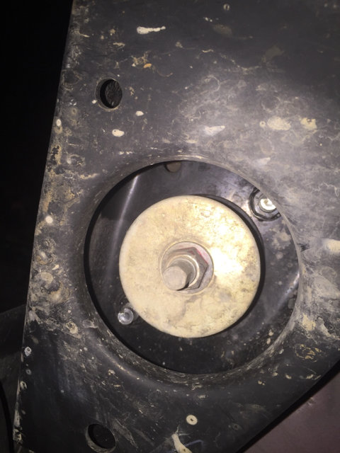

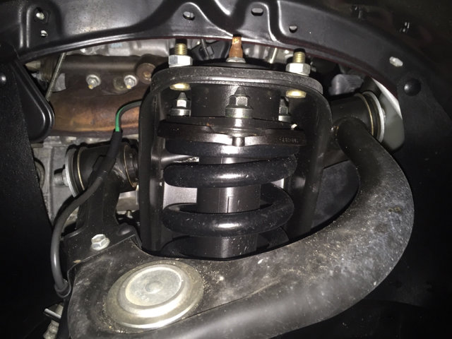

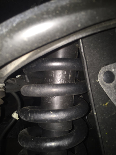

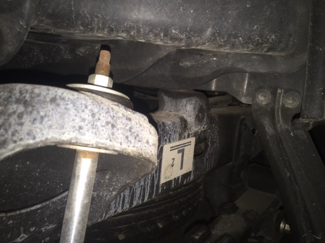

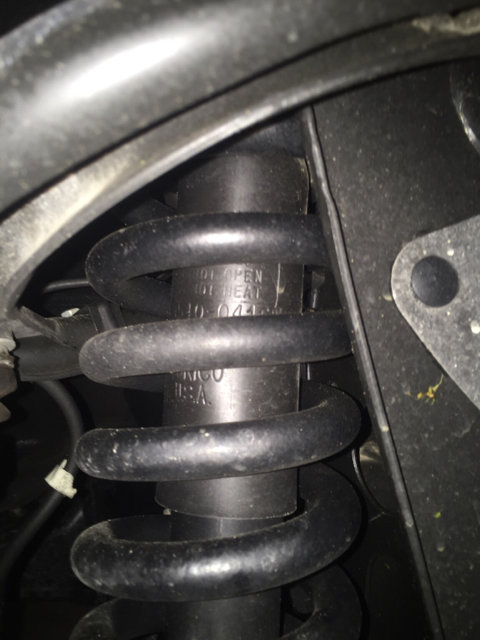

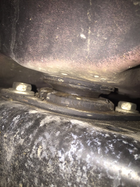

    Hey guys,
    I bought a 2015 Tacoma sr5 used and the dealership I bought it from wasn't much help on knowing what aftermarket stuff was done. Supposedly a Toyota dealership lifted the truck and I can definitely see that when I park next to other tacomas. The question is if it's a body or suspension lift. I am thinking suspension but looking at the shocks and coils it looks stock. Can anyone help me figure out which one it is and what brand the lift kit is?
    Thanks!

    Spacer lift I think,so it's a suspension lift but the bottom of the barrel not good stuff but works to gain height

    There's a spacer on top of the strut and there's a block under the leafs. It's just a crappy dealership spacer lift.

    Cool thanks guys! I figured as much but wasn't sure with the after market "bumpers" and the after market headlights installed

    piddly stuff
    spacer in the front block in the back as stated. to each their own i have about the same lift and love it. on the exspense scale it is the cheaper way to go. if your not going to do any hard off roading it's ok but the other fellas are rt if you really want to do some off roading then there's several different lifts available bilstein, ome, etc. several treads on here all i plan on is mostly highway driving and a little bit of off roadimg when i hunt so i'm happy with it
