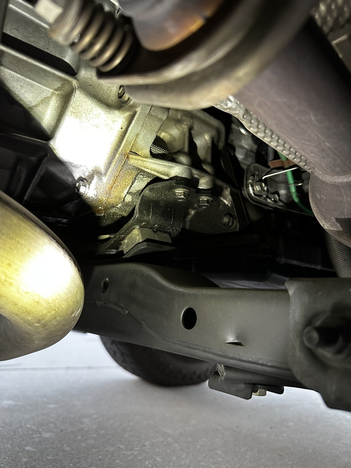

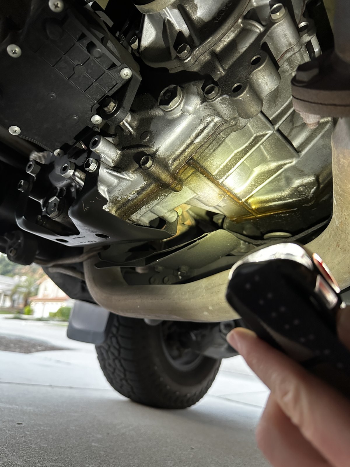

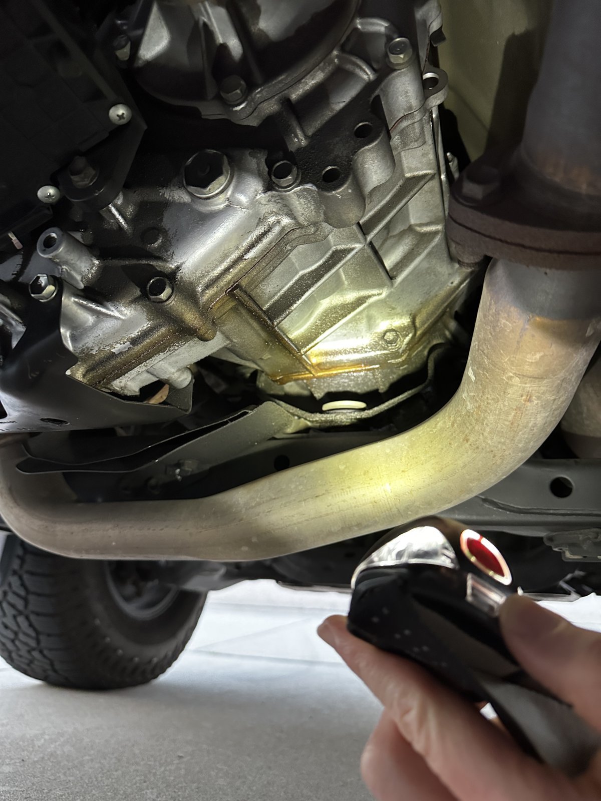

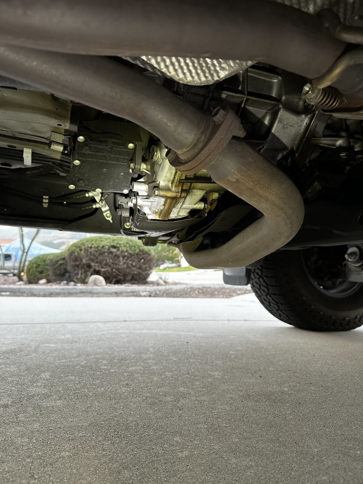

    Wondering if this is a leak of the transfer case? Could it be the front or rear outputs or maybe the transfer case seal itself? IMG_2080.jpg IMG_2081.jpg IMG_2080.jpg IMG_2081.jpg IMG_2080.jpg IMG_2081.jpg IMG_2086.jpg IMG_2084.jpg IMG_2081.jpg IMG_2080.jpg

    What leak? The ground looks completely clean.

    Hard to tell where it is originating from.
    Almost looks like it is leaking from the front and down towards the back.

    wipe it off with a rag and monitor it for a while.

    Clean it with some engine de-greaser and monitor. Much of that oil's been there for a while. Probably a seal in the front of the transfer case, but your (many copies of the same) pictures don't give a full view.
    Maybe you have a local shop, other than a dealer, that would put it up on a lift and take a look.
