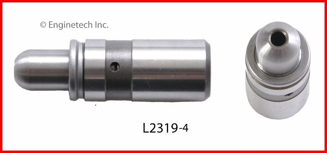

    It has hydraulic lash adjusters on one side of a rocker arm with roller and the valve stem on the other side of the rocker arm.

    I have noticed a tapping when I start the truck on cold days, but it goes away after it warms up. Should I get the feeler gauges out and do some check and adjusts?

    There is no adjustment. It has Hydraulic Lifters or "Lash Adjusters".

    Ah ok, I just researched those and learned something new. Thanks again.
