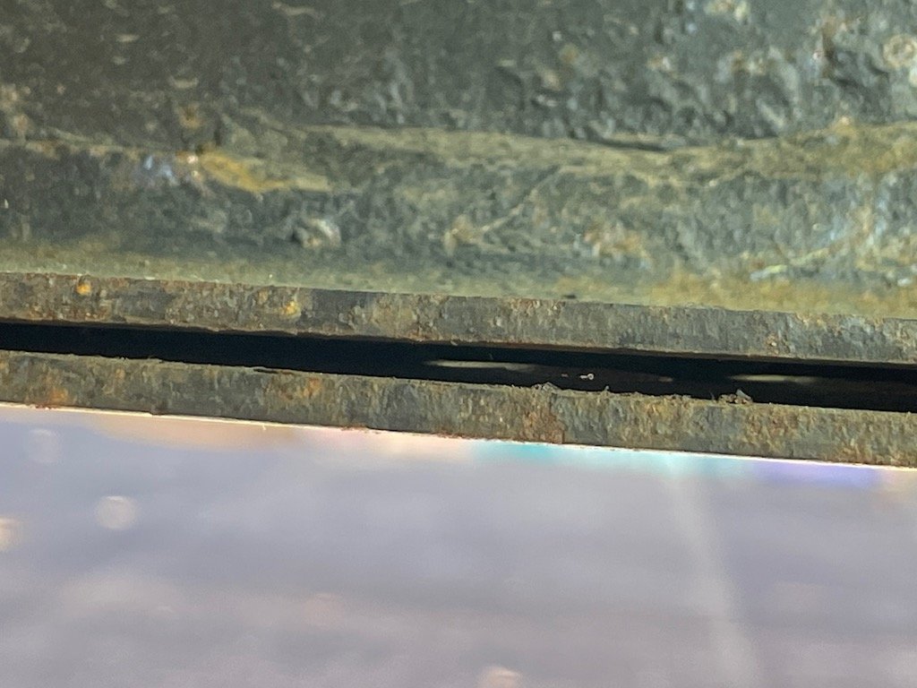

Is this amount of rust bad?

    Rebuilt / Salvage title = Kiss of death on resale value. If you plan on driving it into the ground, you may be ok.
    Also, check with your insurance company on insuring it. They may decline.

    I think the rust in the first few pics is from them straightening the frame in that area.
    Maybe torch and welded, never painted after.

    Yeah he said those first pics are of the repair where it was rear ended.

    the other place to look is the back of the cab to see if the box kissed it when it was hit
    if it did the fram took more than a minor hit
    being a rebuilt title for frame repair probably nullifies the frame warranty and I don't think Utah or Arizona are considered rust belt states for the replacement

    No, sorry, I was unclear. The frame has a couple of layers of metal at the bottom of the C channel, and that's prone to delamination in corrosive environments. Mine looks like this (good), there are recent posts you can find showing how it looks when it's bad.
    And as for the salvage title, yeah, it's kind of a big deal here in CA as you can't get collision insurance. I think that's true in a lot of other states as well.
