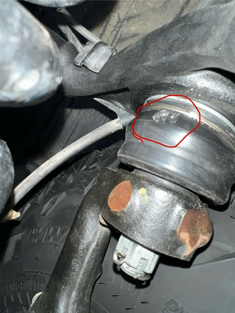

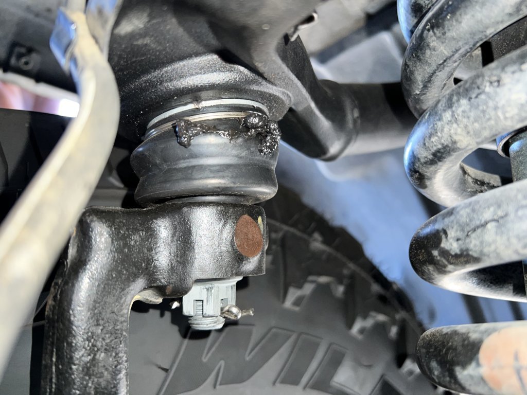

    I just recently installed the OME UCA. I filled it up with too much grease. I saw that it was coming out from the backside of the ball joint. Luckily the website I ordered them from are shipping me a new ball joint.
    So where does the old grease go when you do the maintenance for the ball joint?

    If anyone is curious this is what happened
