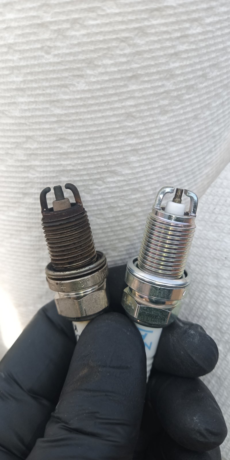

    2004 automatic 3.6L with garbage mileage, 10MPG.
    Just starting to try and figure out why.
    Today I cleaned the mass air flow sensor, new air filter, new spark plugs with wires and boots.

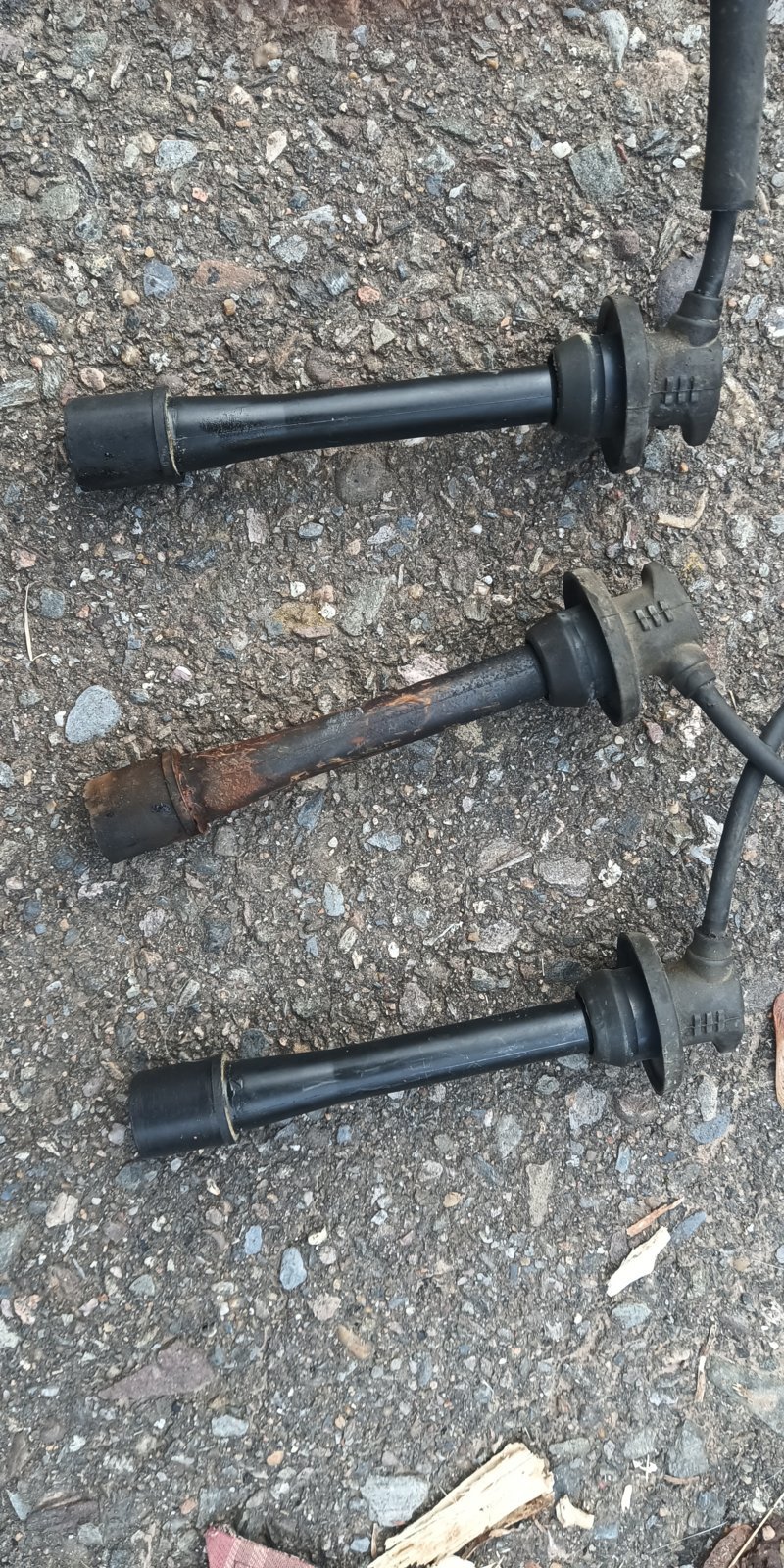

    Noticed the 4th boot was super dry and looks almost rust stained. All the spark plugs looked the same for wear, used but nothing unexpected. Is this a bigger issue? What would cause this?

    Looks like you many have had water leak in from the Top.

    Do you have any oil leaking out of the cylinder 4 spark plug tube area? Wondering if a bad spark plug tube seal could allow water into that cylinder (hence the rust-colored looking residue on that plug boot).
    Agree though that your idle time and winter blend fuel could very well account for most if not all of your observation of low MPG.
