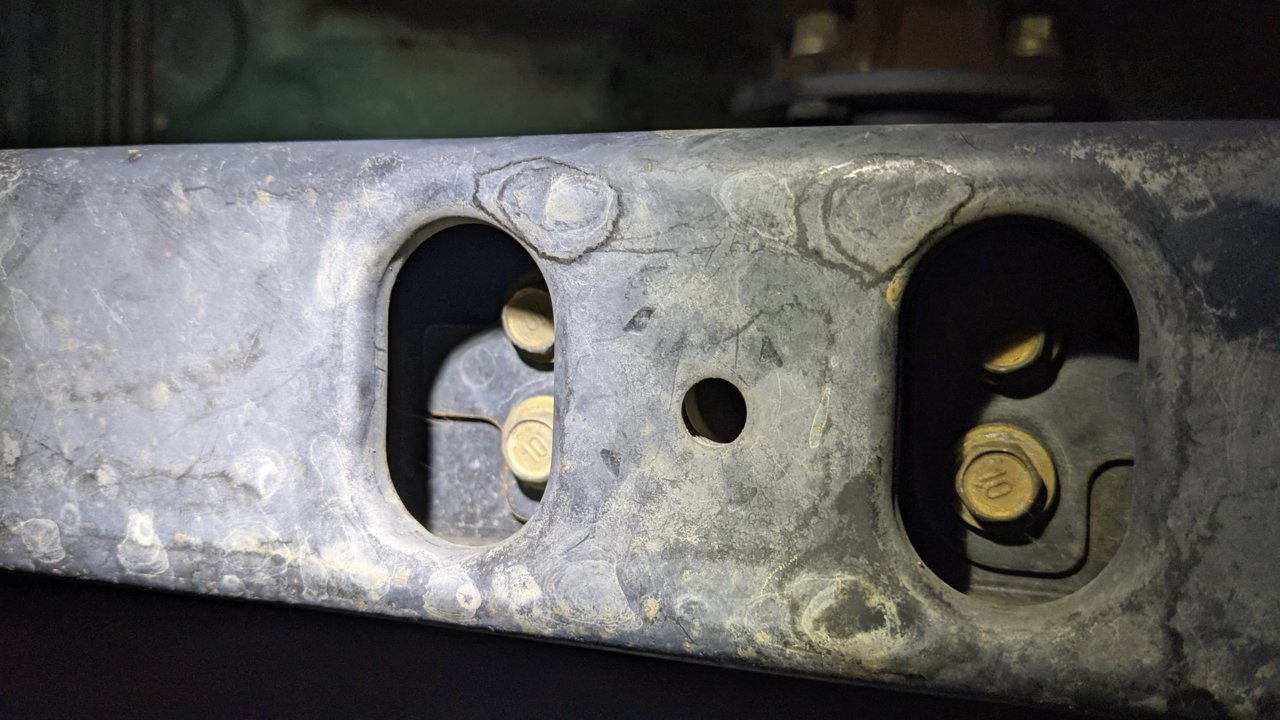

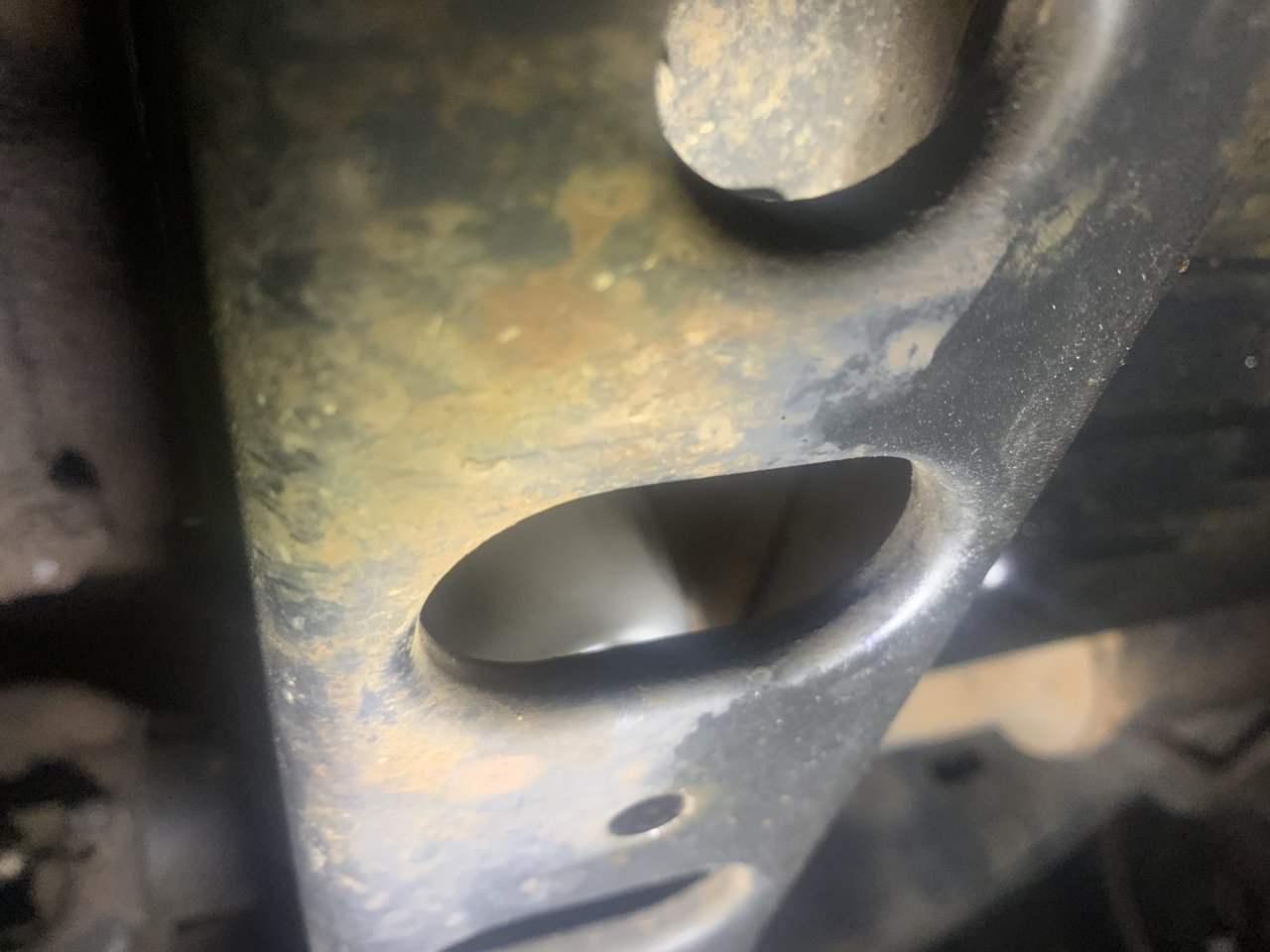

    Just crawled under my truck this evening and saw that a bolt on top of an engine mount (not sure if correct) is spinning freely. Below the engine mount is some threading and it looks like a bolt should go into it.
    Is this a serious issue and what parts should I purchase to fix this? Sorry if the pictures aren't too clear and I can try to take better pictures if it doesn't make sense.
    It's a 2000 Toyota Tacoma with the 2.7L engine and automatic transmission

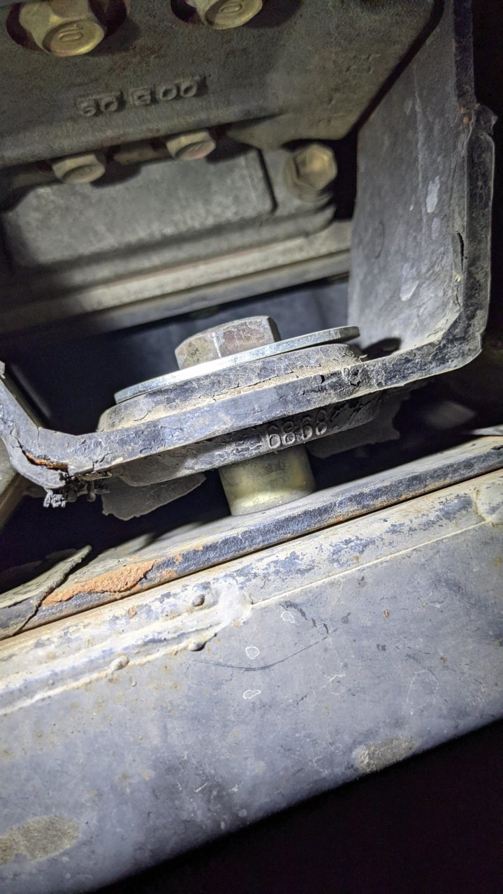

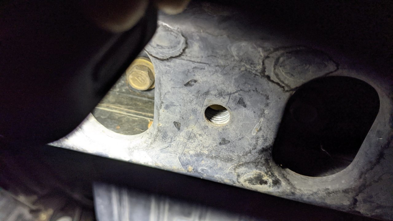

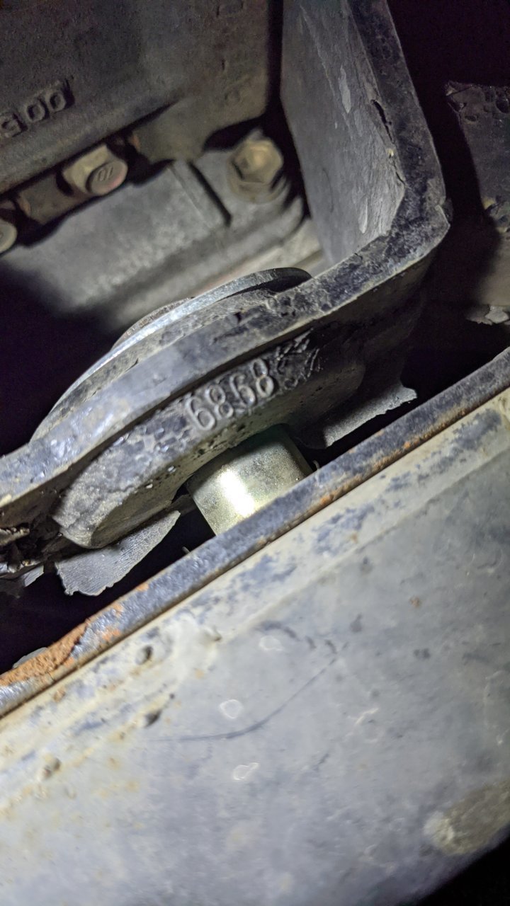

    I took some better wider angle photos. The first is the bolt on top that was loose. I couldn't get it to thread to the cross member so I'm not sure if I'm missing a part or anything.

    D304B8DF-7E71-438D-A302-428F9742476C.jpg Ok, NOW it looks like what I’m used to seeing, funny how too close makes it look like something totally different. You need a trans mount assembly because I don’t think you can get the nylon nut/guide that your missing separately. Bad pic but the large white nylon piece is what’s missing, and yes I just went out and snapped this pic in a whiskey fueled fury! Wife said where you going? I said, my truck, she said, Tacoma world?, I said ya, lol!

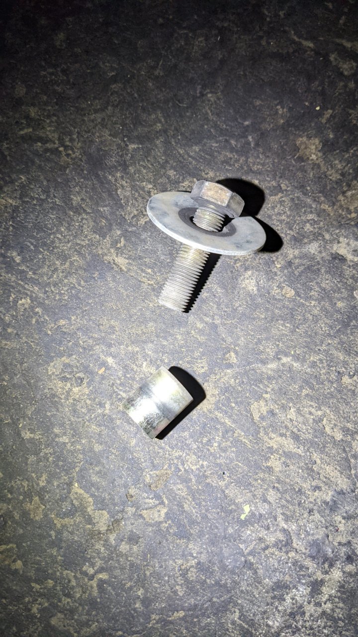

    I think everythings there and nothing is missing actually. I found the nylon piece inside of the cross member and it threads into the bolt. Everything seems to be good or so I hope.

    You should be good then. That bolt is just a retainer in case the rubber completely shears off. Check the rubber for cracks while you’re down there if you notice any it’s a good idea to replace that. Do you have and forward/back movement of your shifter when you go over bumps?
