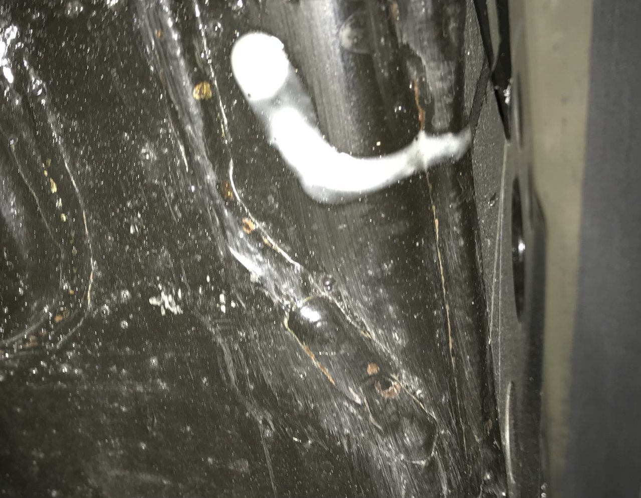

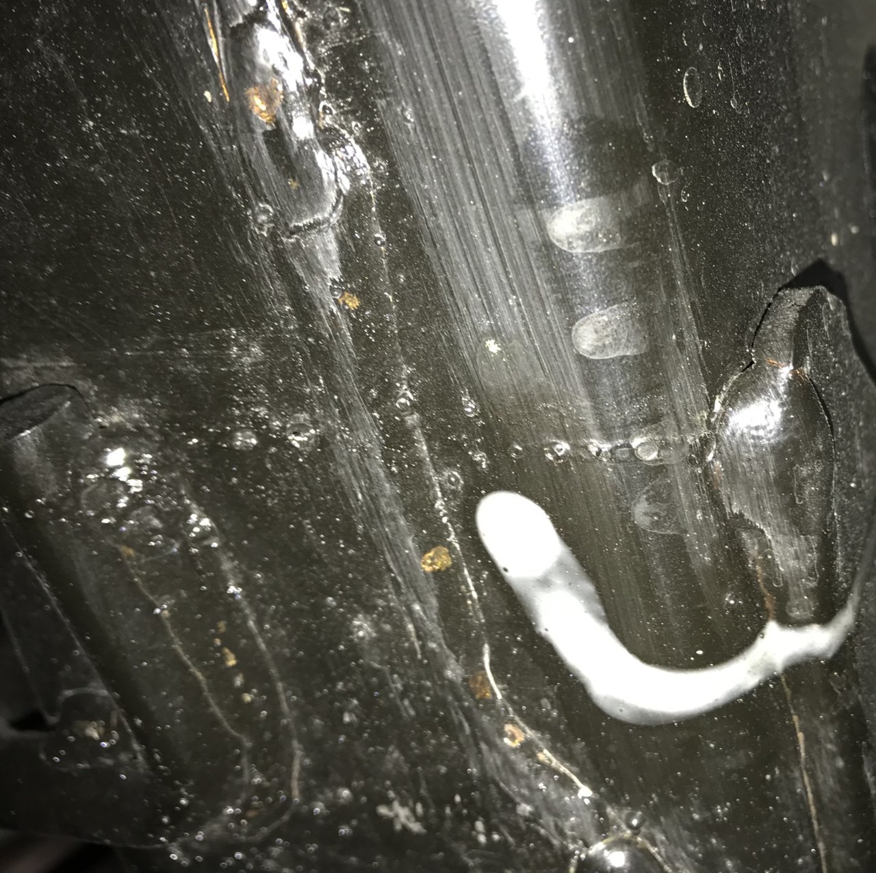

    I got under my taco today to bolt in some predator steps I found on craigslist, and I noticed that the whole frame is speckled with gold and copper colored spots.
    I can’t tell if this is bare metal that is starting to rust, or some type of splatter from something? Snapped a couple quick photos. The whole frame has this stuff all over.
    this is a brand new 2022 DCSB Sport that I purchased a couple weeks ago
    7E1AE551-0ACA-493D-A1AB-64C638918BD9.jpg 970BA668-9F45-46D2-BFCD-EBF013070107.jpg
    Any insight would be greatly appreciated. Learning a lot on this forum, thanks for all your help so far!

    Toyota welds seem to always have those impurities that look like rust when brand new. Mine did as well. They don’t do a good job of cleaning the welds before painting, so the paint recedes around those spots. New paint will not stick to those spots unless you clean them first.
    So, this is “normal” for Toyota, but it is better dealt with than left unattended. Clean with alcohol and a wire brush and spray some satin black on there.
    Toyota is in last place when it comes to corrosion protection on their frames. Even GM does a better job.

    Those gold flecks you see are actually bronze. A result of silica bronze welding done to assemble the frames at the factory. Paint doesn’t adhere to the bronze very well so it’s completely normal for a few spots to show through. If it’s a concern or you live in an area with salted winter roads you can touch it up with proper prep and/or have your frame coated with a rust preventative. Be aware since adhesion will still be an issue, it could return in the future but there’s nothing “wrong” with your truck.

    That's not rust, mine is the same, it appears to be silicon bronze welds.
