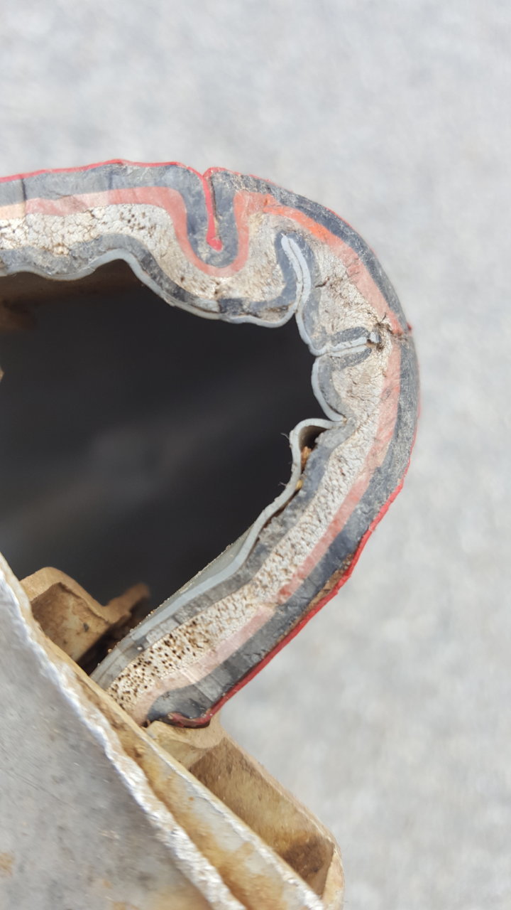

    I got a canoe on Saturday. I paid extremely little money because it is old, badly cracked & broken, and had to be dragged out of a farm pond full of cow manure.
    I used to canoes a bunch back on my boy scouting days (actually did a lot of miles on one during a high adventure trek in Maine one summer), but I've never owned one and have always wanted to.
    Anyway, is this canoe made out of "royalex"?
    I believe it is. I took a sliver of the plastics and put them in acetone and they dissolve. That plus the layering of what looks like vinyl, plastic, hard foam, some other plastic, plastic, vinyl seems to match what I've read online.

    Looks like Royalex
    to me, I use to have a Mad River Canoe that was Royalex.

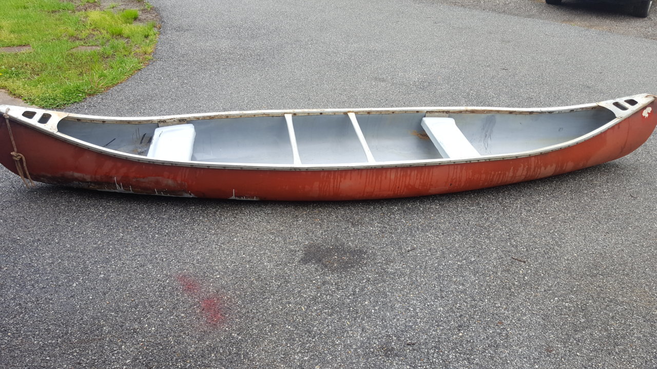

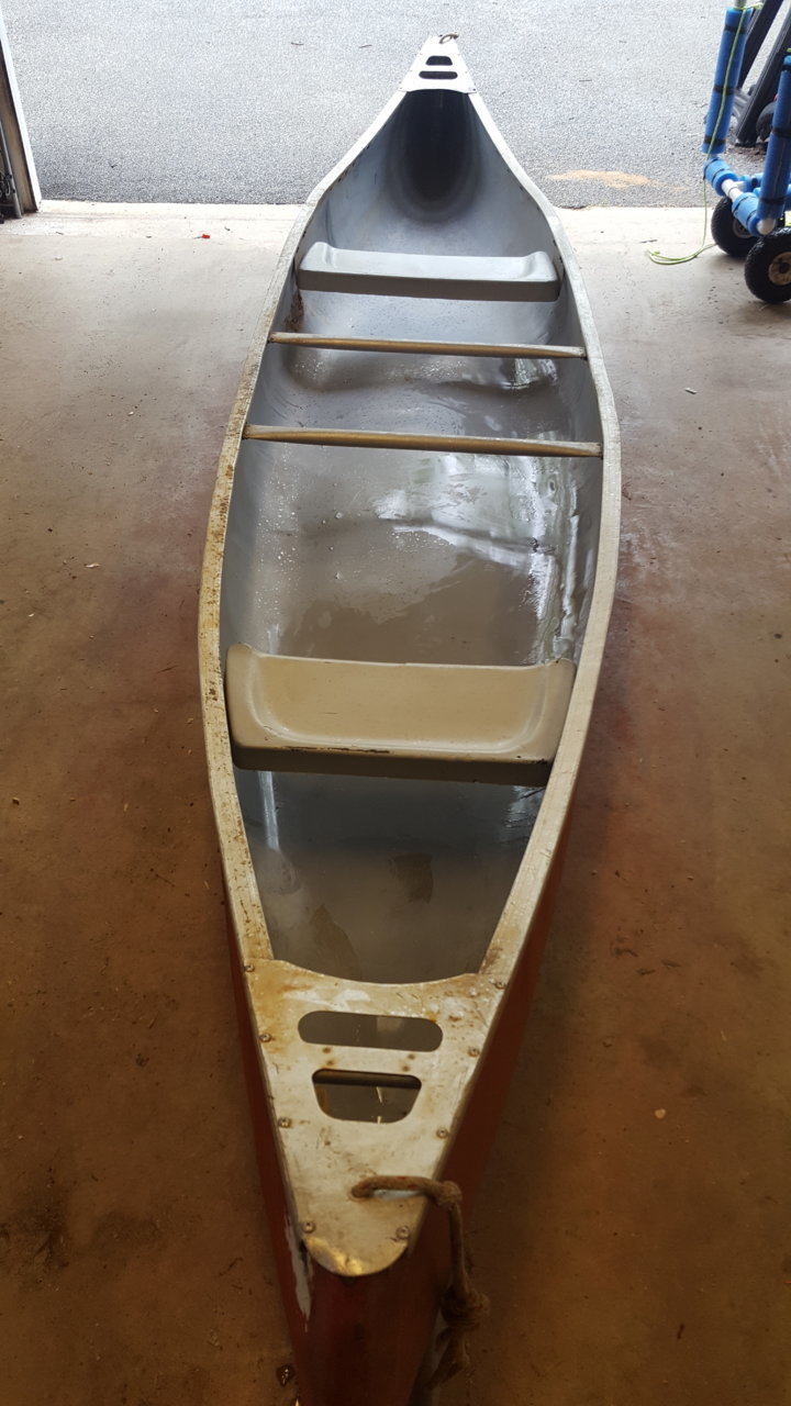

    Okay, here's the details on this boat if anybody is still interested.
    It's 15' tip to tip, 15' 6" total length.
    34" wide at its widest
    About 15" tall at center
    23" tall at the rear
    24" tall at the front
    About 79# in weight (it was slightly damp from rain so maybe a lb or two less than that in reality).
    Here's some pics:

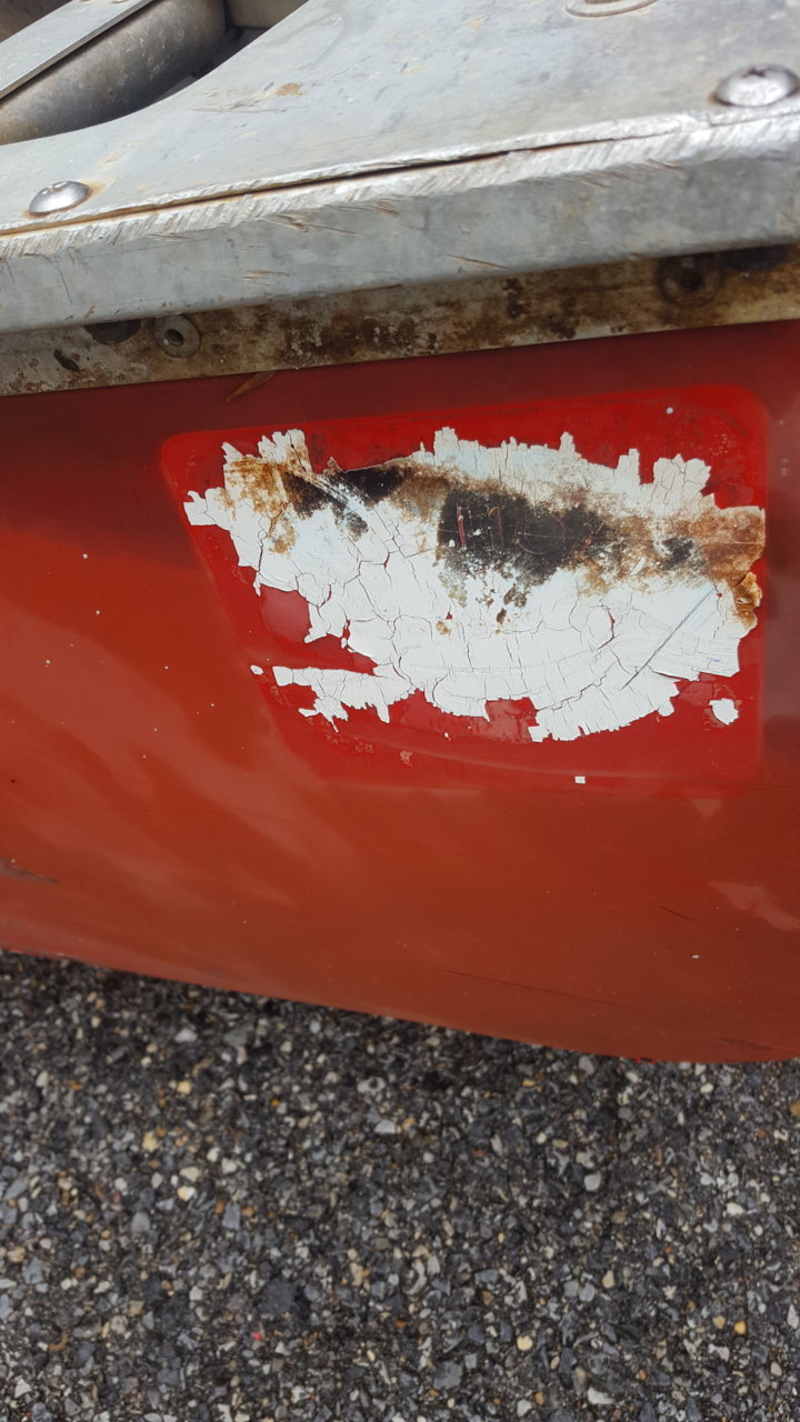

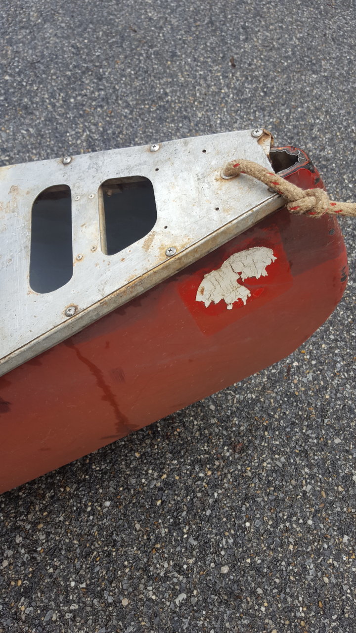

    I've been all over it like a fat kid on a cupcake and can't find any identifying markings. I suspect the data plate was removed as you can see here:
    Does the old decal remind you of any particular maker? I don't know canoes enough to recognize it myself, here's the one on the other side:

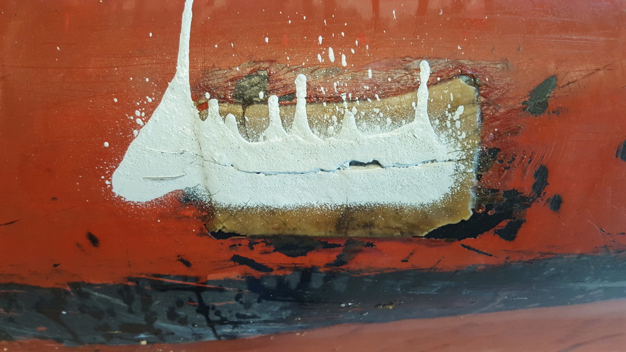

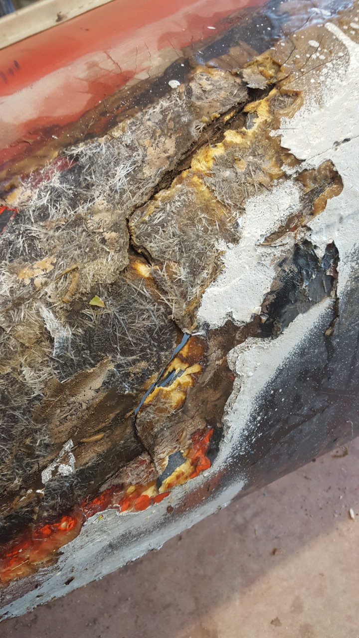

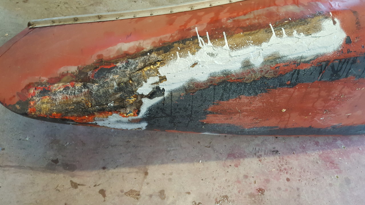

    Lastly, here's some pics of the extensive damage. The cracks and breaks were covered with fiberglass patching which seemed to adhere okay but I think didn't flex with the boat and therefore cracked. I've been working to remove it with hammer and chisel to try to start again but the more I get into it the more I think it's just a lost cause. I should cut my loses and try to find a better boat. But, I'll at least TRY to get it working I guess.

    Wow that’s had some use! I don’t think that is royalex. royalex was normally used in high end expedition canoes. That is a recreational hull. I’m not normally one to say let a canoe die but that old girls best days are behind her.

    Oof, I like seeing old boats saved as much as the next guy but there are a ton of 'free' boats easier to get back on the water than that..
    How much do you like your neighbours?

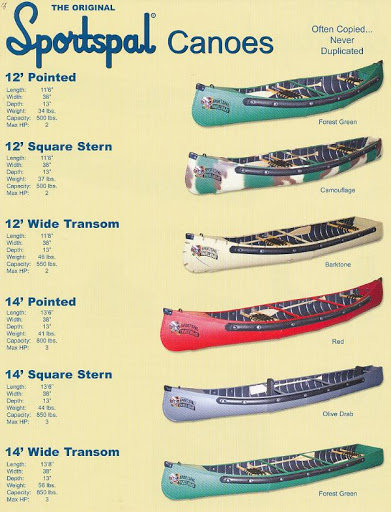

    My Dad collects Sportspals.. he's got three now in different states of 'watertight'.. he has a 12ft and two 14ft models.
    4fq5M6OpSAKFWINC6yNXRl_nB0LeA28rJ3aDEvWA_b0097143506b9203f090eed370d138c90c29cc73.jpg
    I'm a kevlar guy myself;

    Definably Royalex
    That canoe looks like a Blue Hole OCA . One of the toughest Royalex boat built,
    You can repair it with S glass cloth and epoxy resin
    In the 90’s we would buy new Dagger Ocoee’s and cut about 16 inches out of the middle and patch them back together, of the 3 I cut I did not have 1 fail paddling 4 + whitewater
