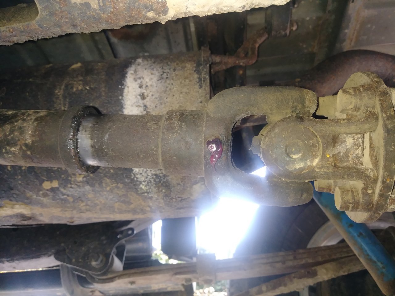

    Been enjoying to get to know the truck, and studying threads on here quite a bit.
    One thing I'm having to do is grease the driveshaft every couple weeks or else I get the drivetrain "thuds" when I let off the brake.
    Any ideas why? This zert right here:

    You sure it's not "axle wrap"? We all get this where when you come to a stop the rear leaf(s) wind up a little and when you release the brakes they abruptly unwind with a "thunk".

    It goes away when I grease it. The first time I greased it it took a while mini-tube of grease.

    That sounds like a lot of grease being pumped into your slip yoke
