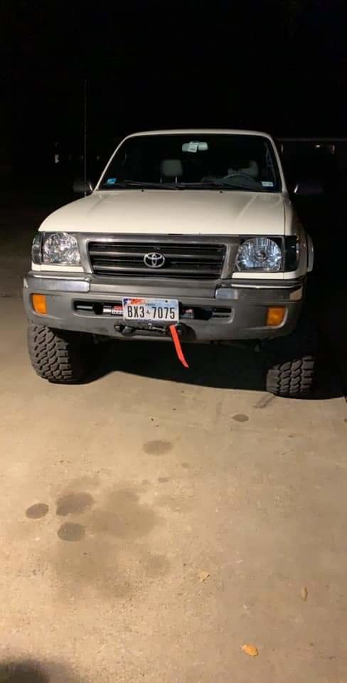

    293119DC-CAF0-4FF3-8DF2-4217E4B03755.jpg Wanted to put a front hitch on my tacoma 97 for I can mount a winch mount to put a winch, but I dont want to mess with approach angle and I also dont want a heavy bumper, I want a flush front hitch mount that I can still use stock bumper but not protrude out the bumper, ik seems like a lot, which is why im asking if its pointless to put a winch in the rear? I already have a reciever in the rear, I dont do anything crazy but like they say “better to have it and not need it, then having to need it and not have it” I will carry this in my bed and only take it out when needed, but I also ask how do I extend the electric cables on the winch to reach my battery? Thx everyone

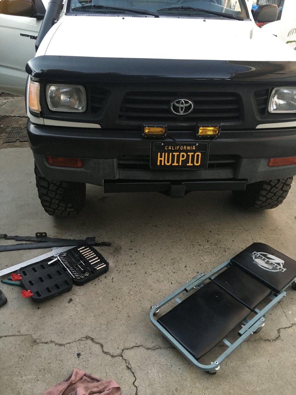

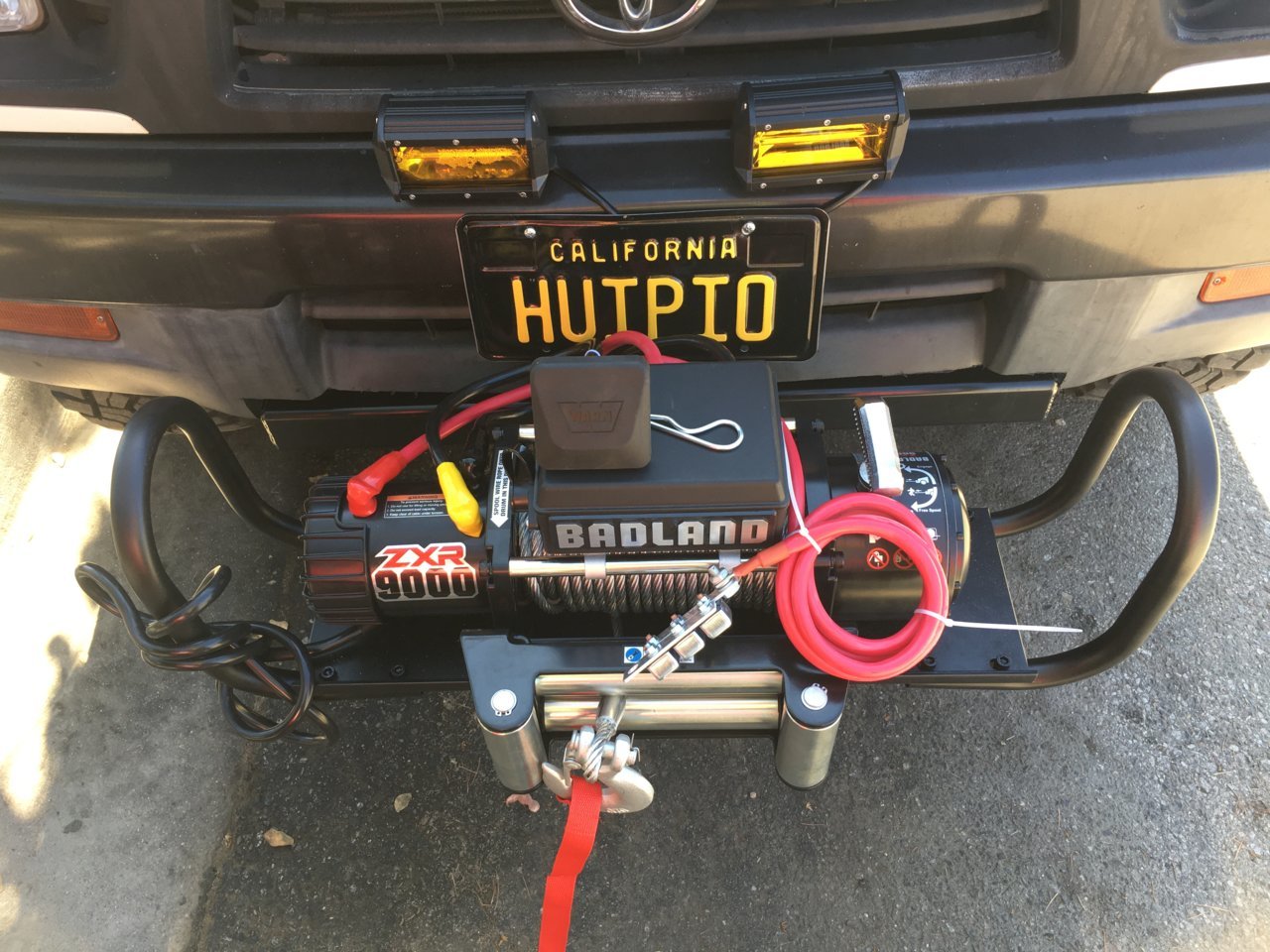

    I bought a Warn front hitch reciever should be here on sunday, I went to Harbor Freight and bought a winch carrier mount and a winch, I do mostly overlanding/canping exploring nothing like rock crawling and the winch really is for me ive never needed it, which is why I went with a budget one, should be installed by 8/15

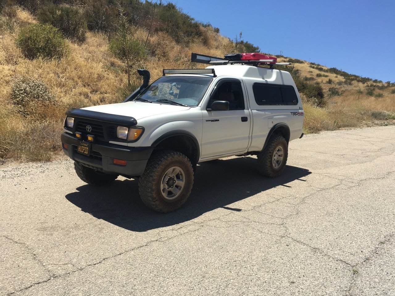

    84346532-FDC9-4711-A9AC-CC4FD9C1E084.jpg 7F71015E-F545-4EA7-8039-21259C73DFEA.jpgI keep the winch in the bed, still havent used it, more of a peace of mind
