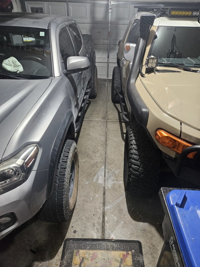

    Loaded questions. I removed my swaybar on 2016 Taco, have 620# coils on Bilstein 5100s, and I drive 75 MPH on freeway without concern. It is smoother riding without it and I don't like it on.
    However, my wife's FJ is lifted 2" front, no swaybar, 700# coils, and I love it, but do not do 75 MPH on turns as it rolls side to side too much for my comfort. It does not see freeway use that often.
    Neither vehicle nose dives any significance.
    If you aren't carrying children, I say try it out first before condemning removal as it is fairly easy on and off. When I see trucks over $10k+ of offroad mods with swaybar on, I assume there must be children involved. In that case, the relocation is worth it.
