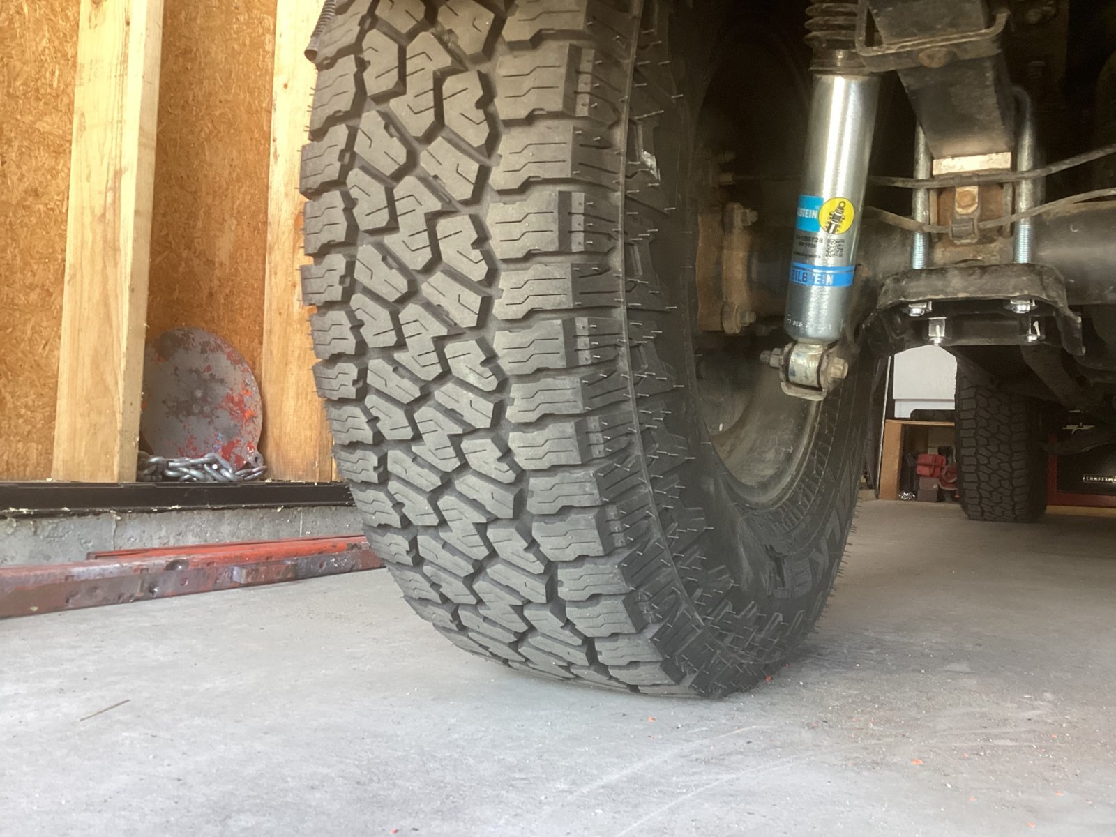

    Could not stand these long U bolt tails. (Pic 1) Tried to trim them and botched it.

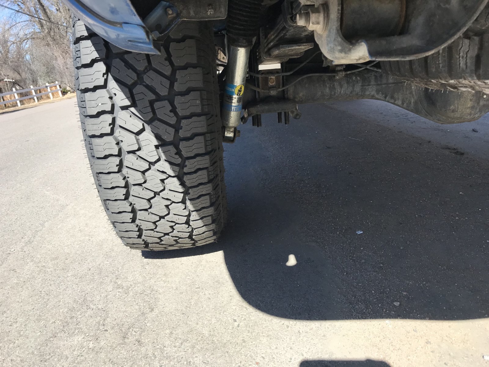

    Got U bolts at Wheelers. Choices were 6.75” or 7.75”. (Pic 2). Is this enough thread engagemeny?IMG_0517.jpg IMG_0018.jpg

    Yes, the thread protrudes from the bottom of the hex nuts.

    I think the minimum is 2 threads past the nut.
    I prefer 5-7 range to allow room for abuse.

    What torque value are you guys using on your U bolts? Haynes manual specs 37 (way too low). Forum searches range from 70 to 90 with 73 being the most common. I went 75 and paint marked the nuts to watch for movement.

    It's fine, the long nuts just disguise how much thread is actually being used, especially compared to stock.
    I do 65ft lbs, 73 always felt like a bit too much.

    90 ft. lbs.... at minimum 3 threads

    Not enough for me.
