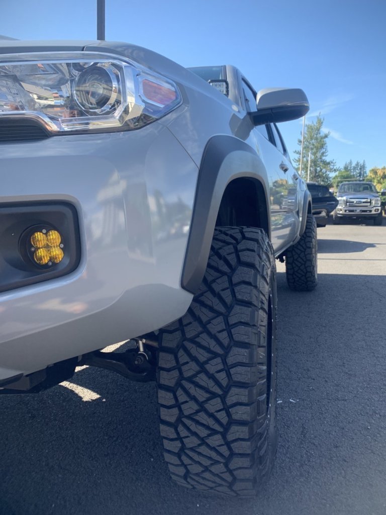

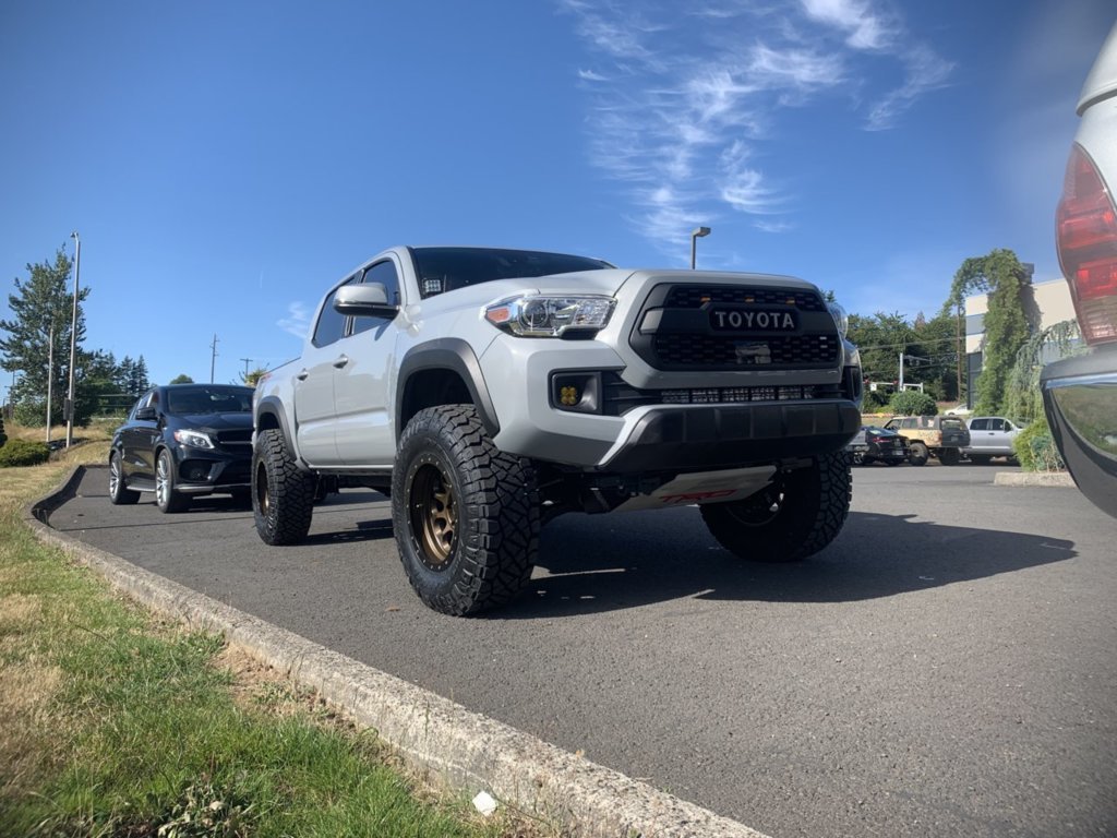

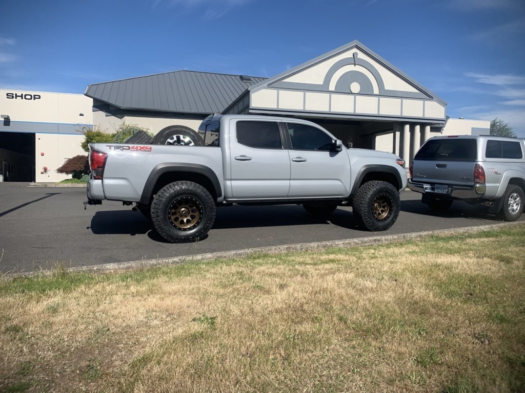

    Not my truck, but this is 6112/5160 and -38 offset wheels. 285/70/17 tires I think...
    55CEC0B4-708F-4FF1-A177-CD623C43C86E.jpg 1BFDA447-BAD8-4B68-8E7E-5FA70D143521.jpg C0D2E012-BD4B-4F5D-9272-E51B75886F22.jpg FFCEB903-B0E6-41E0-AA73-38E8FACF19A6.jpg

    I definitely would recommend having the ECGS bushing done. I recommend it pretty strongly on a 16+ on anything greater than about 1.5" over stock up front.
    A Bilstein 6112/5160 setup won't get you 3" up front by itself. Settings 11/9 will get you to 2" up front. That said... It's enough to "fit" 35s, but you're absolutely going to have to not be afraid of the cutting wheel, and potentially a cab mount relocate to boot. A 315 is a hell of a wide tire to shoehorn in there. As @MGMDesertTaco alluded to there will be a significant amount of clearance-ing needed to allow for full articulation of those meats. If you want to keep the can of worms to a minimum and still have a very respectable sized tire I would recommend something like a 285/75/17. About .5" smaller diameter, but over 1" less width which is where the issues show up.
    Everything else looks OK. As mentioned before, the SPCs have fallen a little bit into the questionable relibaility category as of the past couple of years. The full adjustment at the UCA is awesome, but it does come at a potential reliability cost. Our darlings have been Dirt Kings as of late as we haven't had a single reliability issue with them. That said, if you absolutely want UCA adjustability and don't want to spend billet/heim money the SPC is still the best option IMO.

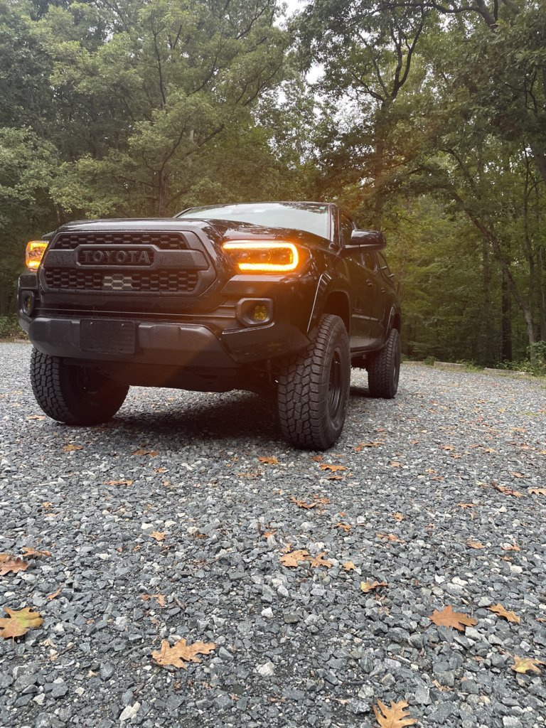

    I’m running 33’s. I think it’s the best tire size out there in terms of form vs. function. It’s the perfect amount of both unless you need a bigger tire for a practical reason, which it sounds like you don’t. A couple different 33’s I’ve run:
    Yokohama Geolandar AT4’s:
    Yokohama g003:
