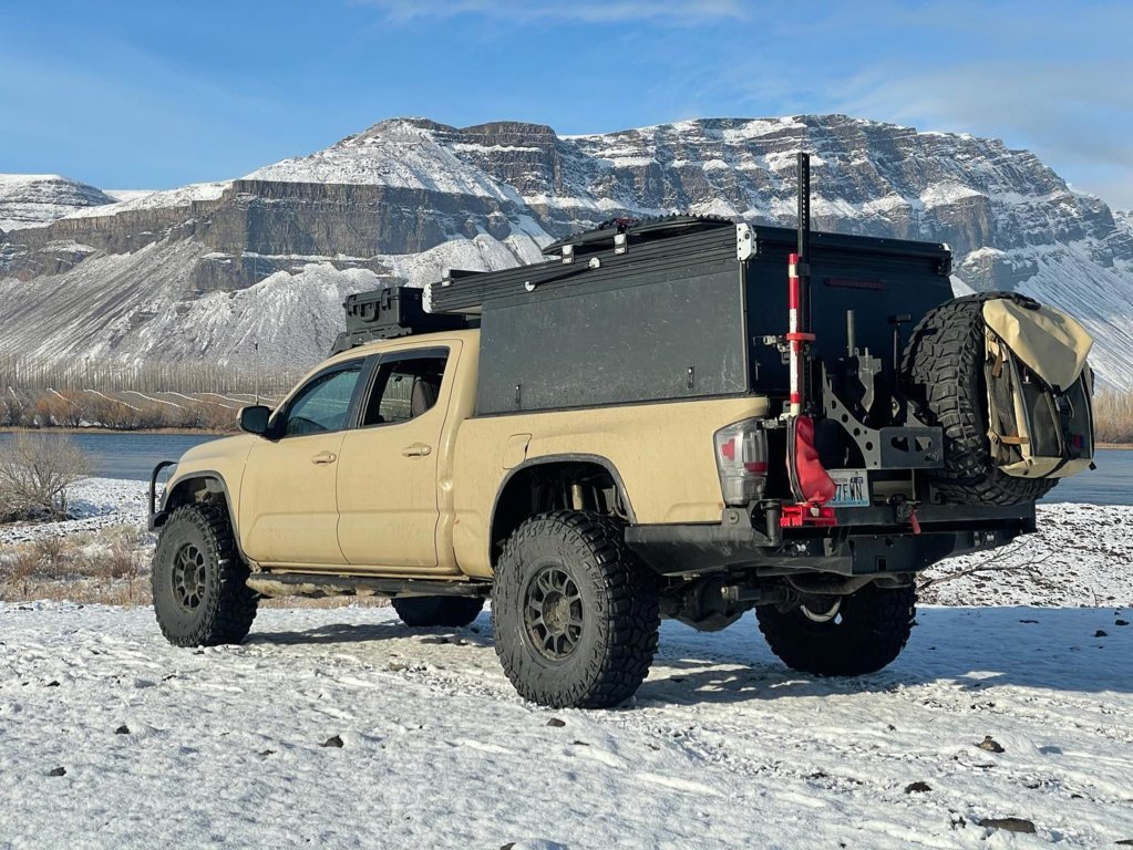

    Can't find a better pic... I know I have one somewhere. Friend of mine has 37s.
    Here we go... just needed to raid his FB:
    134941092_1531310667257515_2833493454248_d5b6493db7c88bd69c51dcd15e44d9af580d3d22.jpg

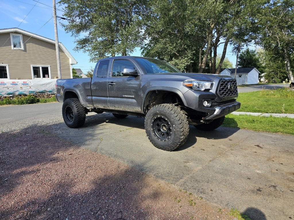

    icon stage 10 kit, toytec 1" bl, 35" general x3s, 17x9.5 procomp wheels, locker anytime mod, s&b intake, blackhawk 2.1 tune,
    heres my truck. -38 offset and 35x12.5s. also a pic comparing it to 285s and -12 offset. buy the c4 fabrication big tire fit kit. comes with cab mount relocate, high clearance inner fenders, and a cut template to cut your fender flares (i cut significantly more than the template). youl still need to do some major hammering to rear inner fenders to clear tires.

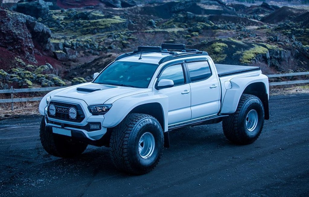

    Dream bigger. This one on 38's
  15. Jan 2, 2025 at 4:15 PM

    Pretty sure they were unloading that at Mule last time I was there (last year at an open house I think?). Had just busted an axle or something on a BDR trip or something. Cool rig for sure, but I think a bit overkill on those tires. Those poor axles, haha.
