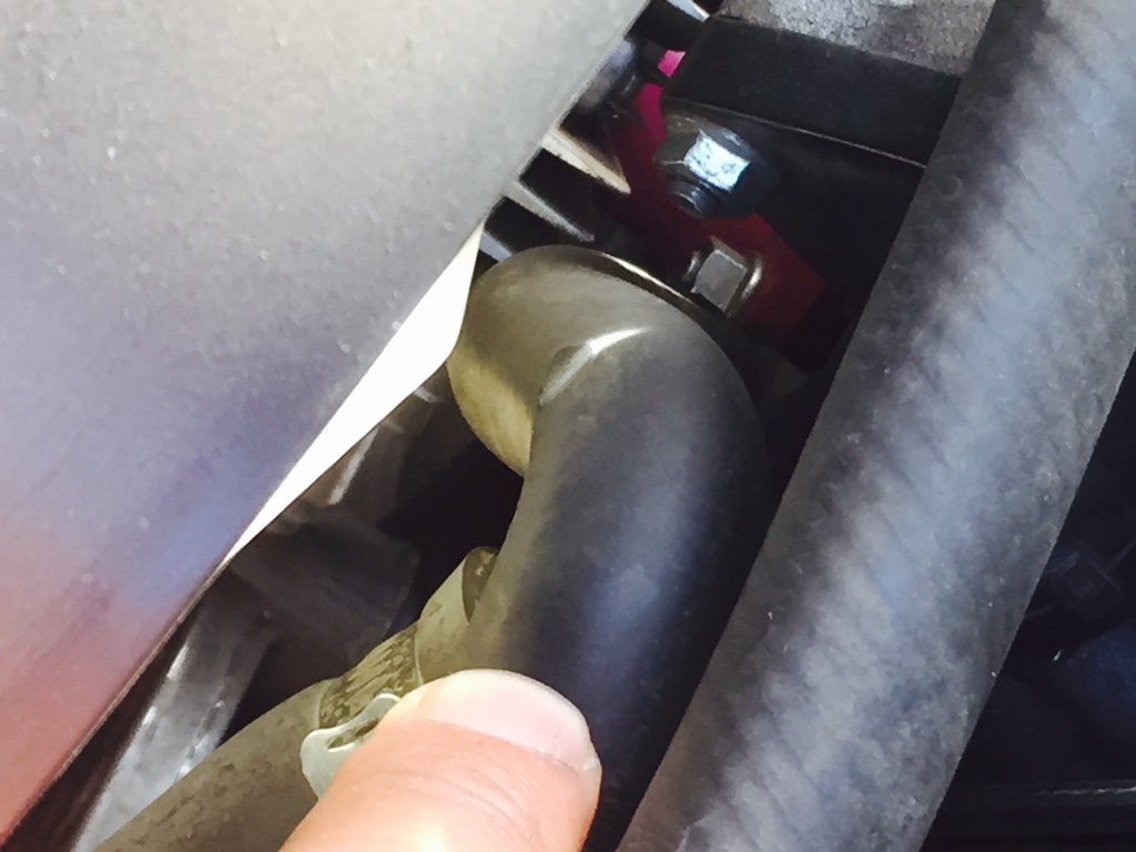

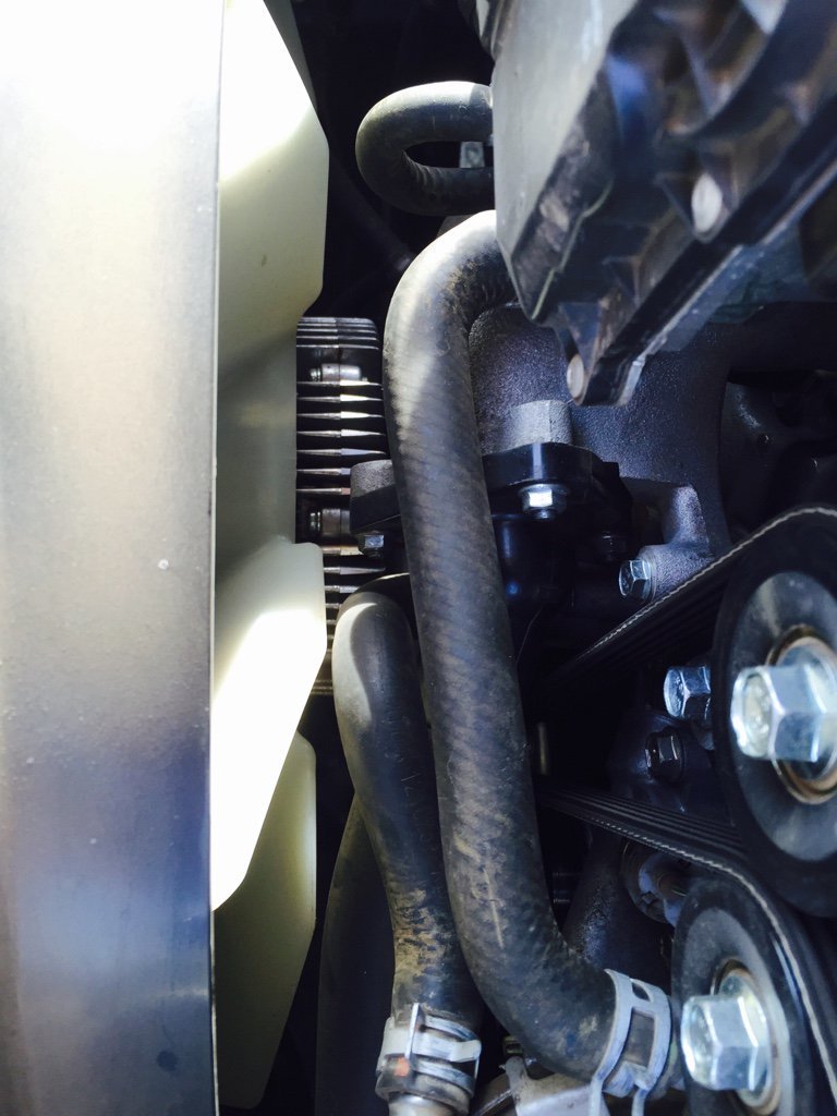

    Noticed today that there is very little clearance between the fan blade hose. It actually looks like if has touched it a bit...figure this not good. Is my hose bulging out more than normal?

    its out a lil far. mine was the same way and i zip tied it to the other line to get it away from the fan

    x2 for the wire tie

    The clearances there are particularly tight. It amplifies when you have a blower. Best to use ties and plastic looming when attempting to avoid contact and stuff. That reminds me I have to loom up a section of radiator hose that ocassionally contacts the oil filter drain tube.

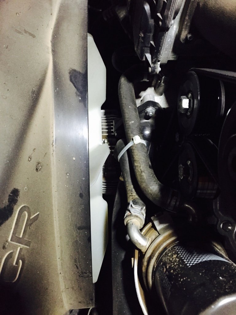

    Zipped. Much better. 248886e1f2190471a04aced5887ce36a_ffeb11b43edecf1e31e3d1cfd6e515a0c6db5c12.jpg
