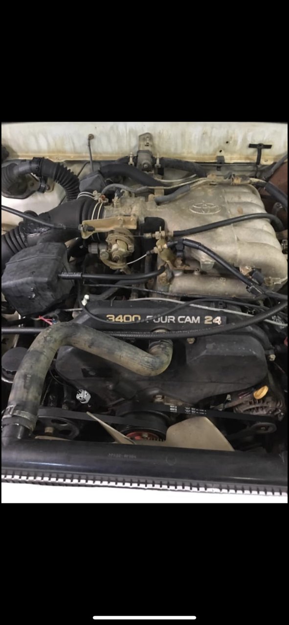

    They could have cracked it there is why they welded a plate. From the color of the manifold and exhaust she looks like she spent some time in the mud. That tells me the frame may be worse on the inside towards the back if it's got mud in it too.

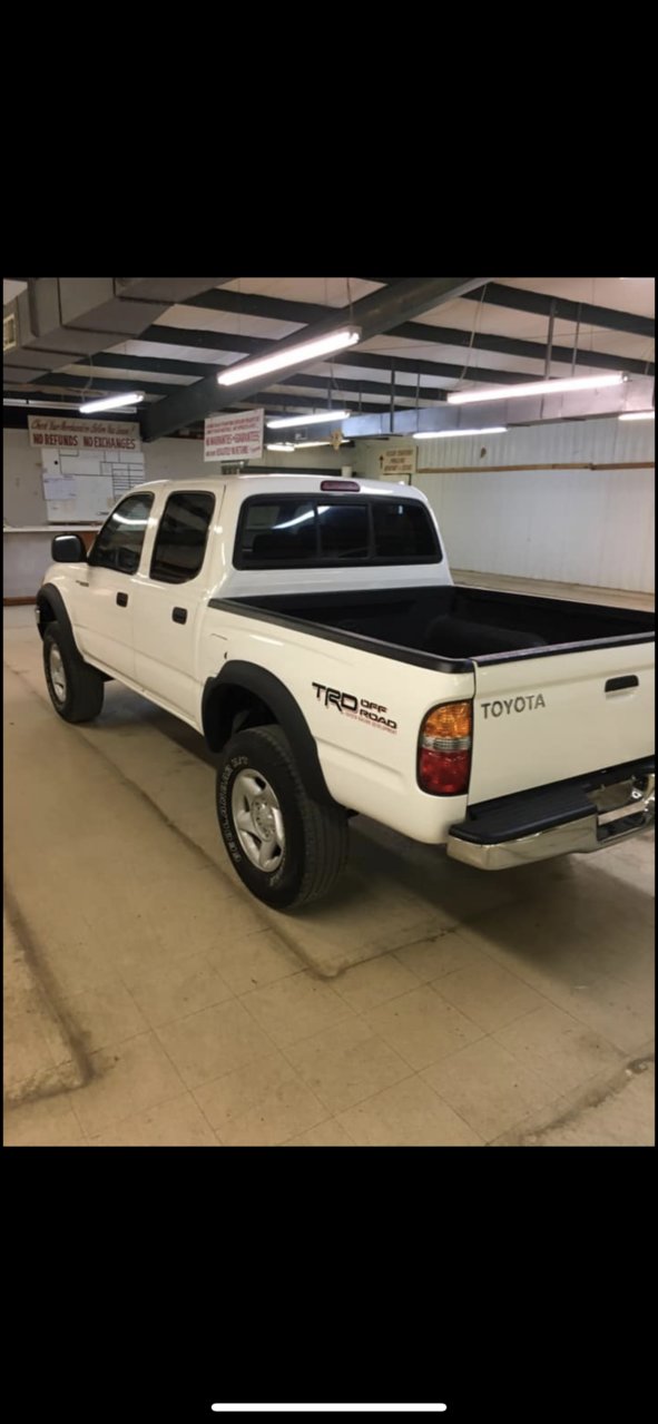

    are these frames boxed in at the back or can i inspect that?
    sadly up there where the plate is I have no way of checking inside.

    You can put a borescope inside one of those factory holes in the frame and view the inside that way. I think Harbor Freight sells a cheap one
    I would also see if the owner will let you take a ball peen hammer to it and smack it around the frame to see if anything crumbles.

    still, be sure to check that frame carefully...it really does look like they painted over rust and the fact that a big metal patch was welded in can't be good. If you're comfortable with it though then I would definitely use that as a bargaining chip to bring the price down.

    234k miles, DCSB 4x4 TRD. asking 6750.

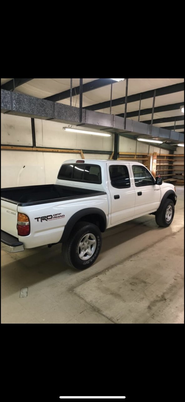

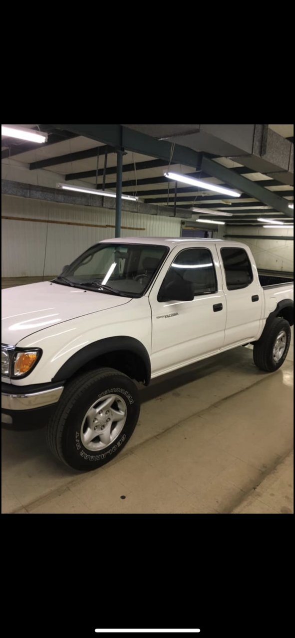

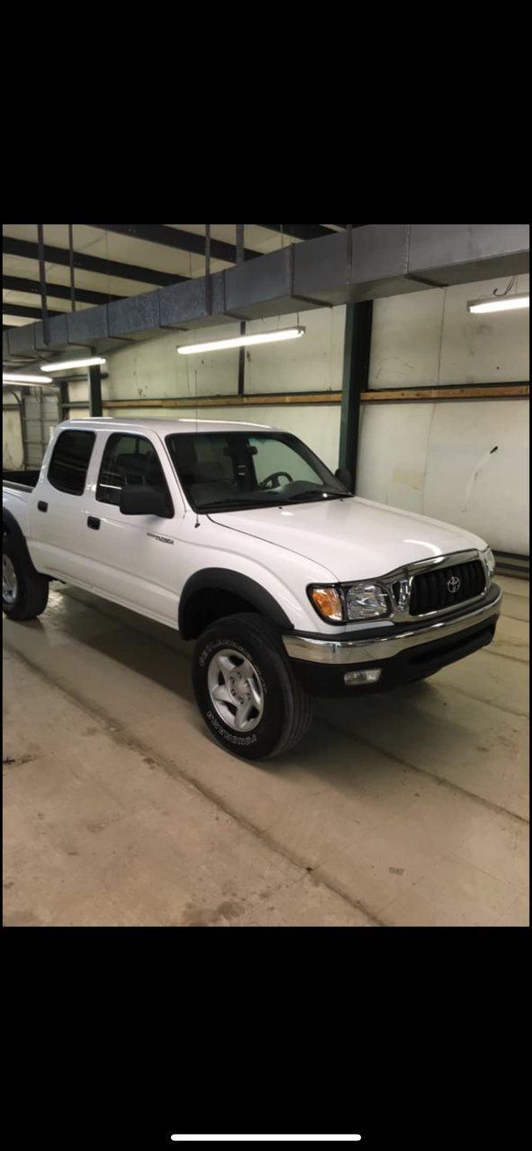

    It seems too nice to be true. I know where it’s at and know of the business. I do not know the man though. Will definitely go strapped to look.
    The photos are screenshots I took. Apparently I can’t save pics off fb marketplace.
