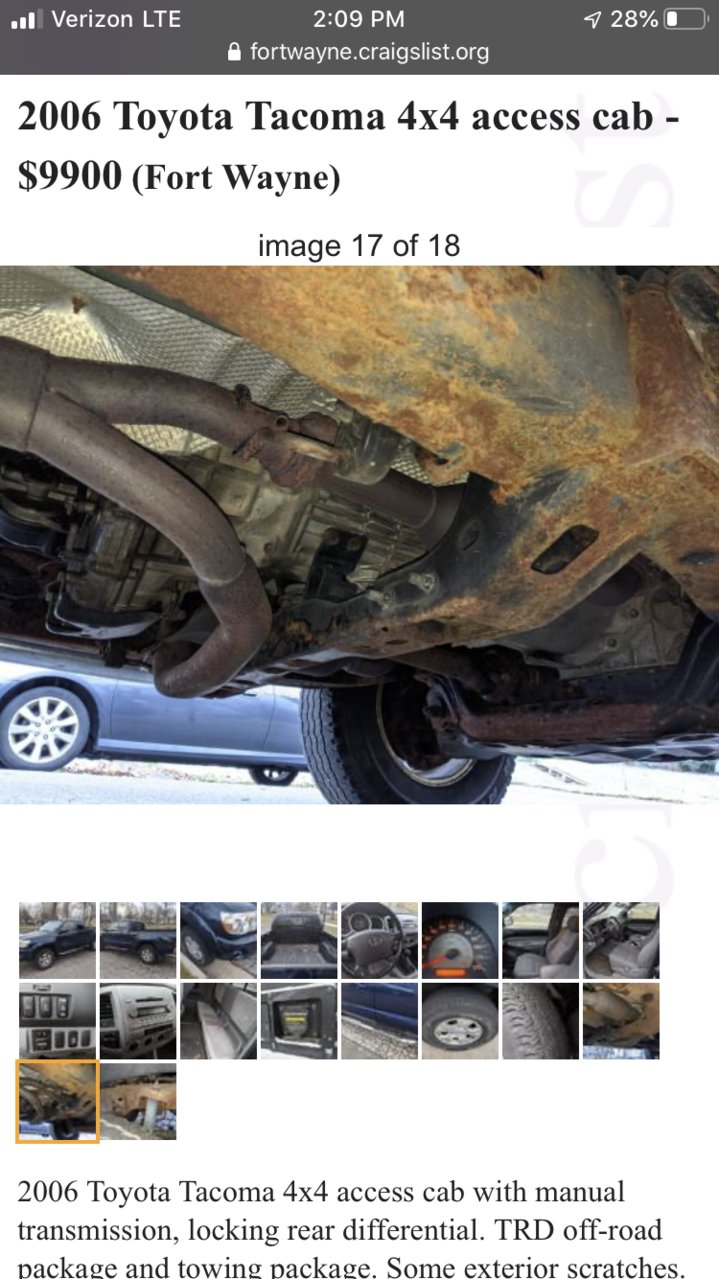

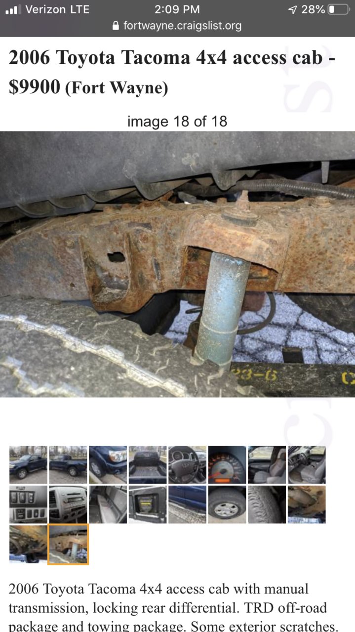

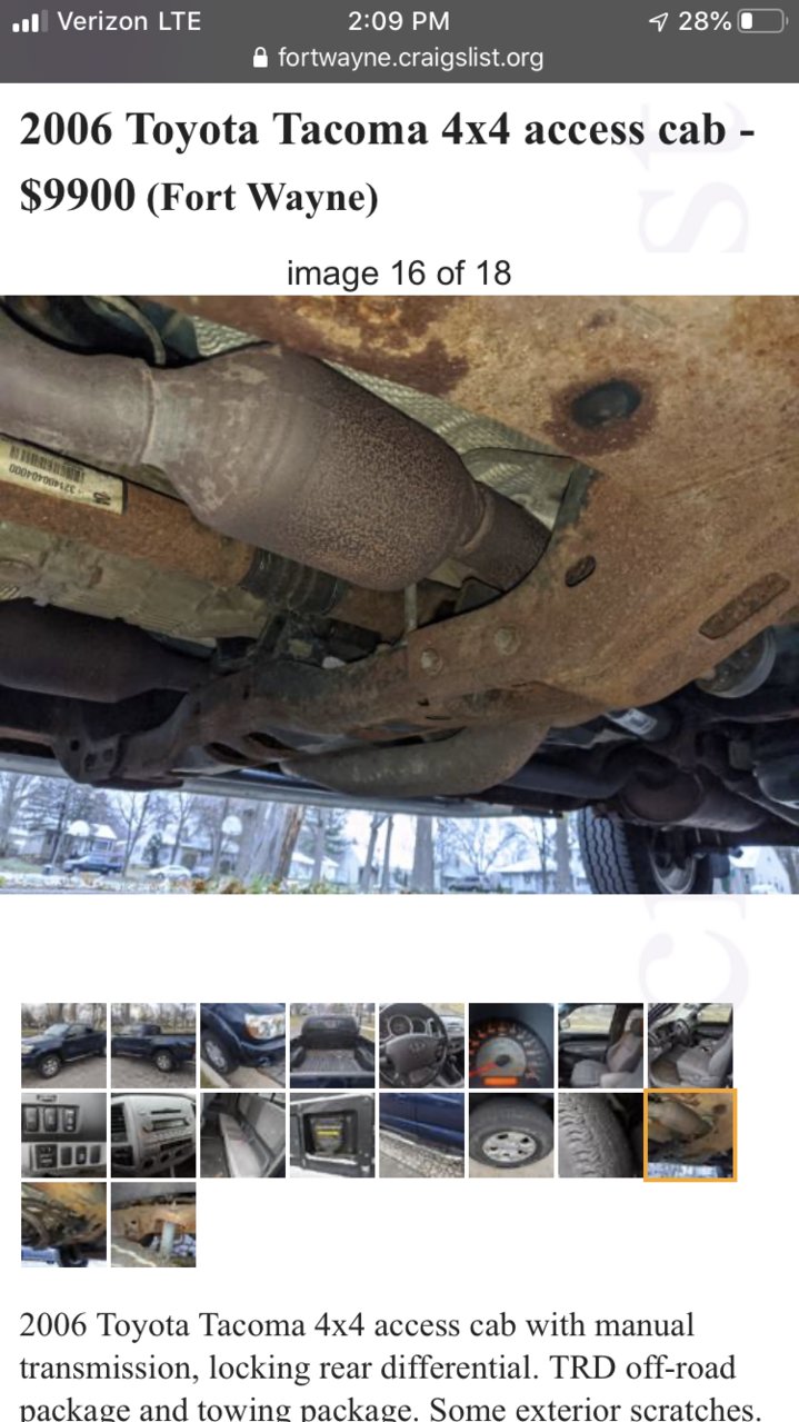

Is this frame rust acceptable?

    no rust is acceptable. knock a few grand off also depends what your using truck for. daily driving no. haul stuff around land maybe ok

    Rust + 06 with possible motor mount / headgasket issues. Wouldnt touch with a 10ft pole.

    Looks fairly good to me. Just check every inch of it to make sure there aren't any holes or soft spots. If you do end up purchasing it I'd wire brush it and coat it with POR-15 or at least some Fluid Film.

    Pictures are inadequate for most rust evaluations. You need a physical exam with a hammer, pry bar and borescope.
