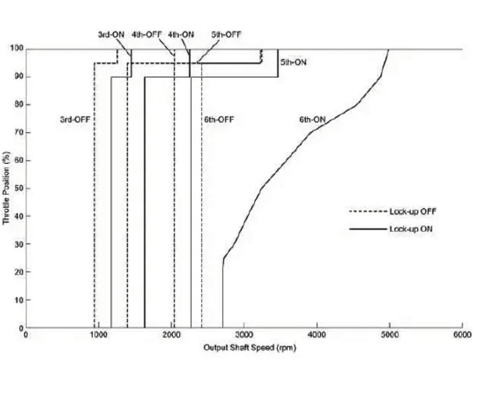

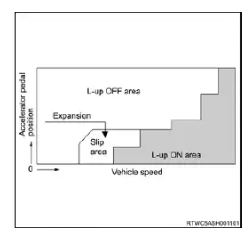

    Both. 1600 mile trip a few weeks ago and I never saw TC temps rise higher than pan temps except in 3rd when climbing a 6% grade. I'll have to figure out how to display lockup status and watch it.
    Also, those lockup schedule graphs you quoted arent making sense to me lol

    They don't make a lot of sense to me either, but I found them quoted in another thread and thought they could be useful for someone.
    Lots of rolling hills around where I live and that's where I see the TC locking/unlocking the most often in those varying conditions around a fairly constant speed.
