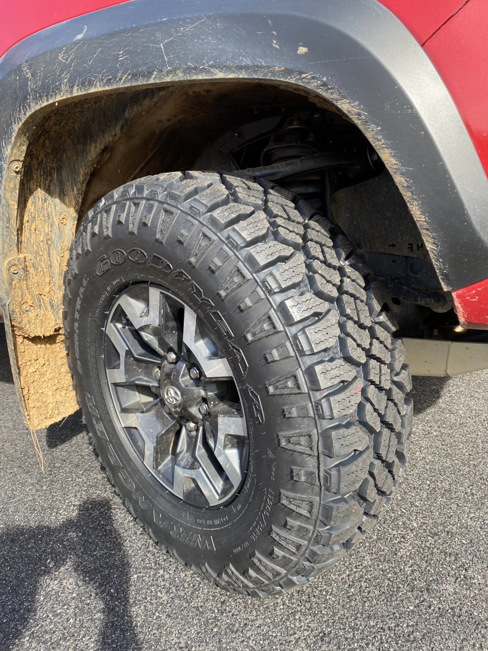

    I took some measurements (With stock tires-Wrangler-Kevlar) with front wheel locked and if the 265/75/16s rub it would be against the mud flap on inner edge of tire. I think removing the mud flap would easily eliminate rubbing. I guess I won’t know until I get them installed. I want the extra 1/2” ground clearance with 75s and I don’t mind the look of no flaps

    I installed 265/75 duratracs on my stock rig and had no rubbing until i installed the wheel spacers. Now i rub on the mudflap area at full lock sometimes.

    I got my Duratrac 265/75/16s today on my stock 2016 TRDOR. They are awesome. No rubbing even articulated. No comparison to the standard Wrangler with Kevlar in mud.

    You'll clear the hard stuff (UCAs, CMC) but you'll probably rub the front fender liners at full stuff. The good news is it's easy to fix that with a Dremel.

    What is CMC? And if rubbing fender liner occurs is it the center top or at an edge?

    Cab Mount Chop. With bigger tires you'll need to trim back the cab mount so the tires don't rub it.
