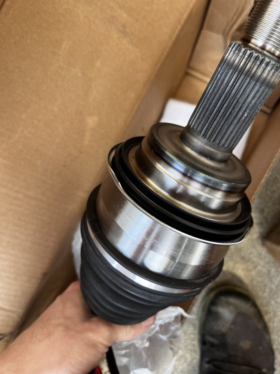

    I’m doing my first attempt at a solo cv axle replacement and noticed something about my new axle. Is it still good to be installed like this?24D5D233-A10A-495D-BE53-EE29B8809DFA.jpg

    It’s just the dust shield. They commonly come bent up. You can gently bend it back to shape and be fine.
