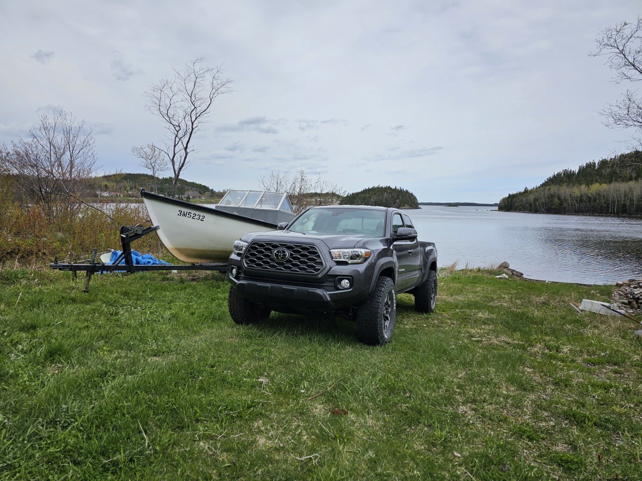

    heres my truck with no lift and 285s. coilover lifts onlt raise static ride height. they dont clear bigger tires. when you hit a bump or flex the suspension the tire is still gona move upward right to the bump stops

    285/75r16. stock wheels. 2" wheel spacers. cab mount chop. no cab mount chop needed with bora 3/4" spacers
