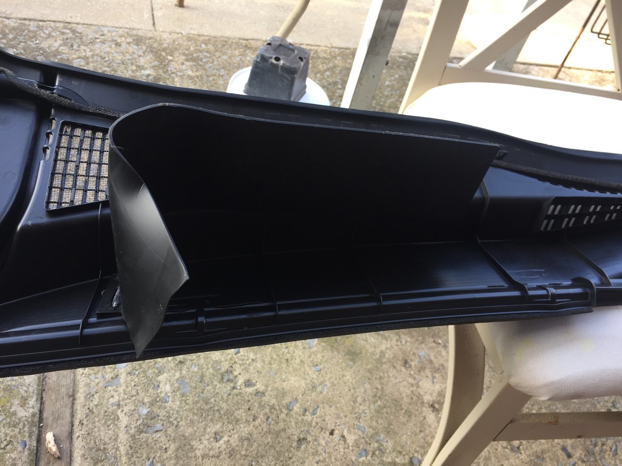

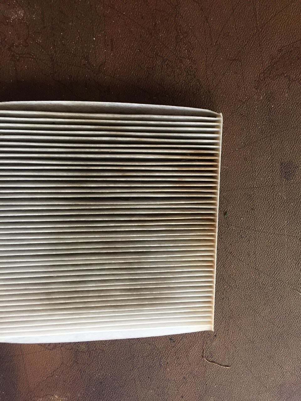

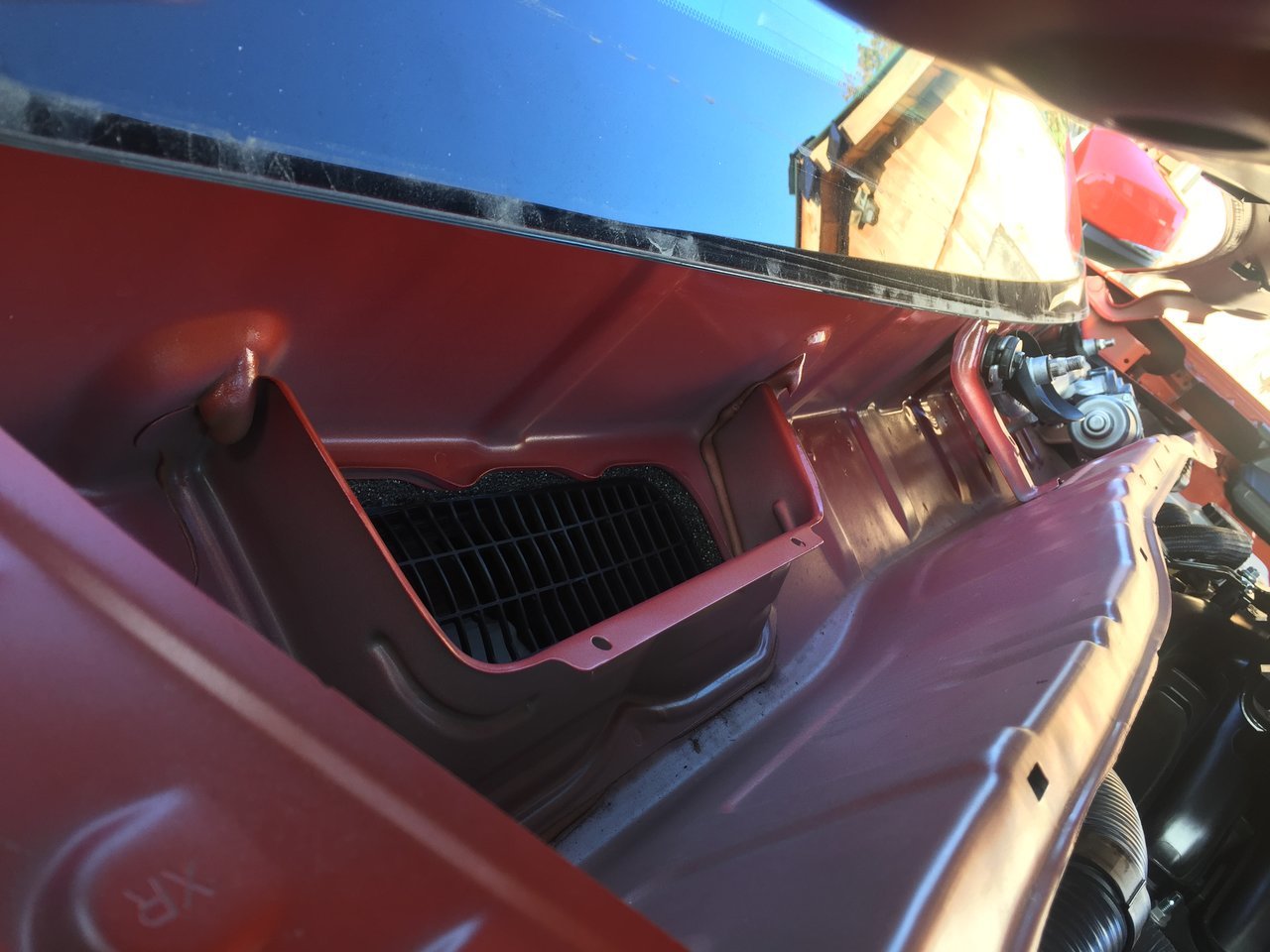

    I noticed my 17 trd or leaked aliitle much like even when I did not use the air conditioning. So after investigation and finding my cabin air filter with moisture damage . Ended up being cowling was installed wrong . The rubber flap was on the inside corner

    The cowling has a flap shielding the cabin air intake above the cabin air filter . So when I would park on a lean small amount of water would inter down in and out the drain . I have pictures but I just don’t seem to know how to lied them to these messages
