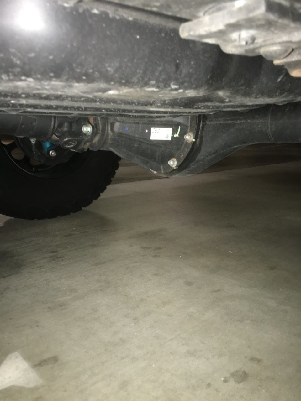

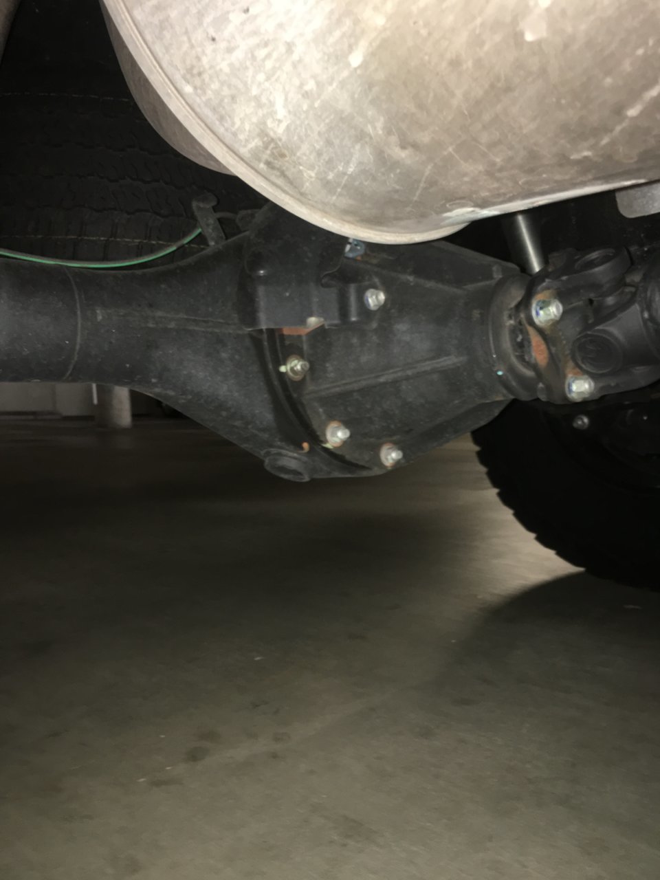

    Hi,
    I noticed this “leak” today. I didn’t see a puddle or anything but it got me concerned. I own a 17 TRD OR with less than 8k miles. Thx in advance.

    Not normal, there's a tsb for a rear diff leak, basically they just retorque to bolts. Take it to the dealer

    Damn. I hope nothing got Efed up.

    naw you're fine. just get into the dealer.

    Just made an appt. I thought I read somewhere that there’s been a recall on the 16-17 Tacoma’s due to rear diff leaks?

    Correct. Didn't include the OR though.

    Makes sense. The service advisor told me there hasn’t been any recalls on my vehicle.
