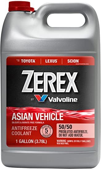

    I'll 2nd the Zerex. Been using it for years, in many different Toyotas, without issue.

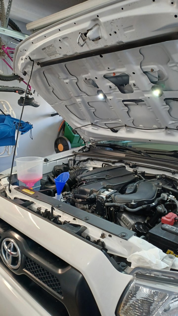

    jane...is that a Mobil 1 filter I see in that picture there?

    Just use the xerex Asian. Walmart has it for cheap.

    Unfortunately they don't carry it anymore. It was replaced by Peak Asian and Walmart's own house brand formula.
    But O'Reillys and Advance Auto often have it on sale
