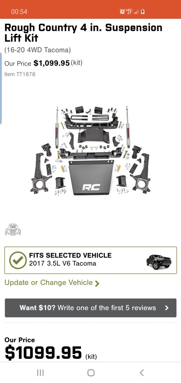

Is this lift set up good?

    Do you really need or want a drop bracket lift that is going to require cutting the front cross member out?

    No, it requires cutting the cross member which is hard to reverse and is restrictive for off roading.
    To some people it even lowers the resale value.

    It is a lift that requires major frame modifications to complete. Rough Country has been a round for a while. Decent enough product. Don't recall reading anyone here using them. Would not be my choice for a lift.

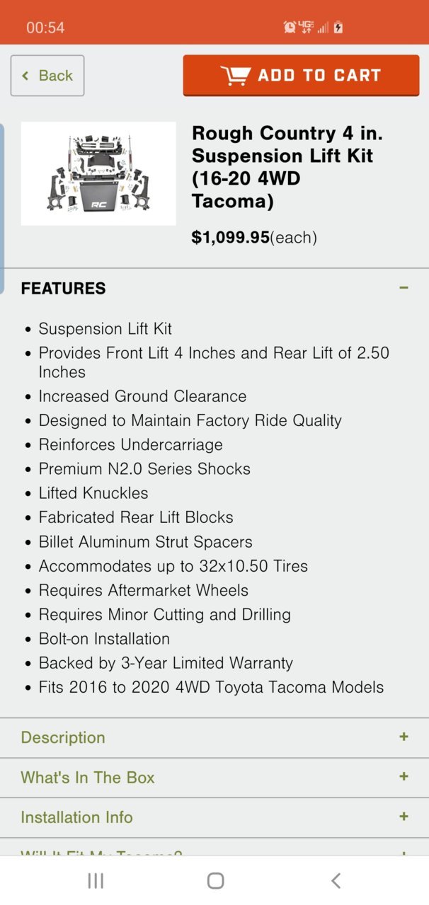

    Its funny how it says "requires minor cutting and drilling" and "bolt on installation" in the same description :rofl::rofl::rofl:

    Accommodates up to 32x10.5" tires. Well, thats honest.
