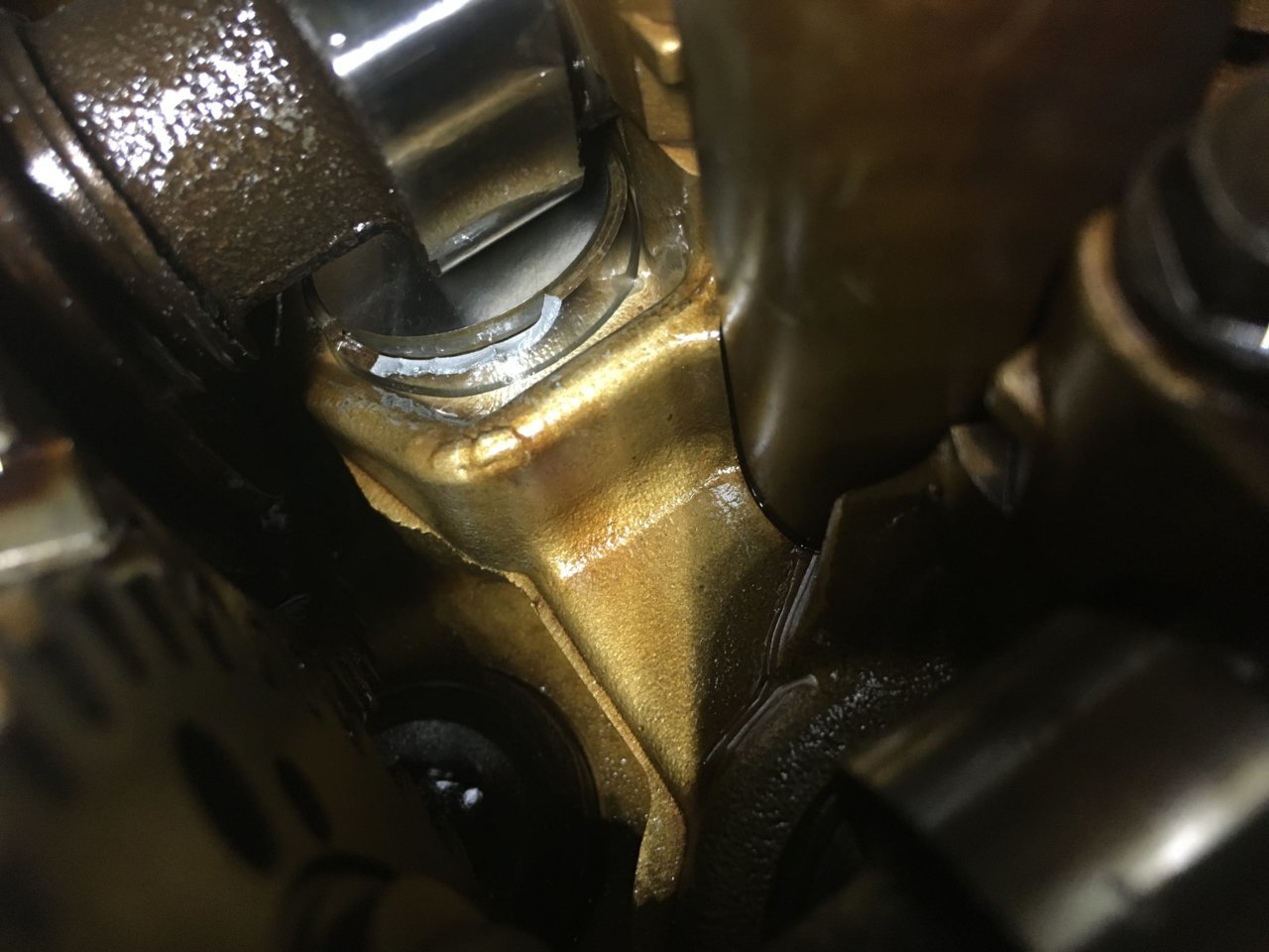

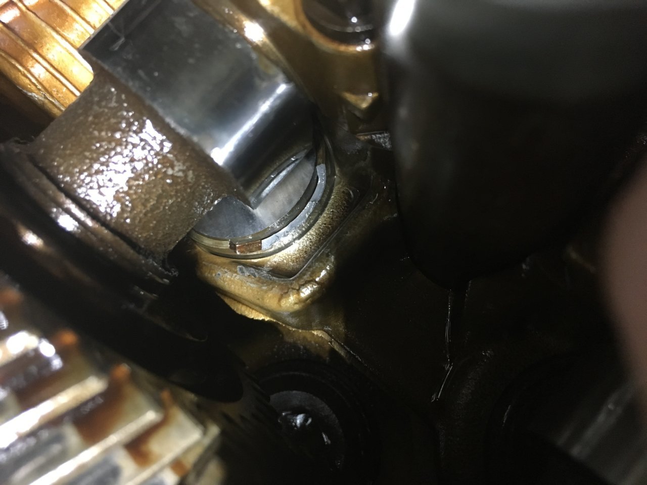

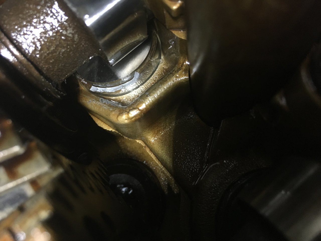

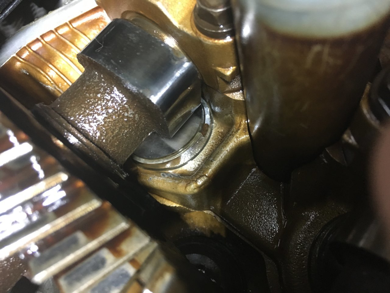

    Hey, everyone, so this is linked to my previous thread about the "easiest way to remove an intake camshaft." This is the reason why. When I was pulling the valves to be machined I accidentally cracked part of one of the lifters, and I was wondering if it is safe to run like this. I cracked about 1/4 of the rim counting the machined notch.
    I would rather not have to go through the process of stripping the front of the motor down to the crank to remove the timing belt just to replace it if I don't need to. I did get the Tacoma for its legendary reliability though, so if it is something that will severely jeopardize that then of course I will concede. I was just wonder what people with way more knowledge and experience with these vehicles think.

    ehh. i would be afraid it might break some more and spit the shim.

    Yeah I was a little afraid of it getting ejected at high speeds too and ruining the cam lobe :(

    Yep. At high RPM there is a chance of the shim becoming a free agent.

    So I potentially have just created a random VVT mod! You don't know when or if it's gonna happen, but when it does, it will certainly affect the valve timing :rofl:
    Thank you guys for your responses. As much as I didn't want to do all that extra stuff to remove the timing belt, I suppose it is unavoidable. :(

    Might do more than a cam lobe honestly.
    I would change it
