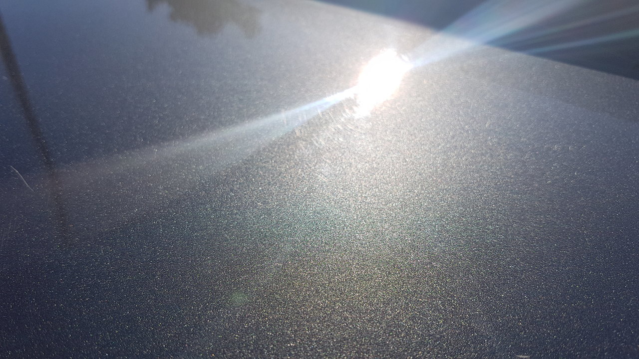

    So I picked up my new 2017 taco last week from the dealer. I'm gonna give it its first full detail this weekend. From clay to seal... Soup to nuts.
    Question for you all. This looks like DA marrying to me. Do you all agree?
    Plan is to use my Portal Cable DA with some Megs Ultimate Polish with a finish pad to correct this. Of course, will be clay barring before then following the Polish up with a synthetic sealant and yellow carnuba wax.

    Are you talking about the light swirl marks? If so, that could just be from their car wash brushes and/or poor quality drying cloths.
    I use Griots perfecting and finishing sealant all in one step but what you are using should work fine.

    Yes. The swirlz!!!

    I had this on my truck as well from the dealership. These swirls eventually go away after a few car washes and some wax. Drove me nuts at the time.

    looks like standard swirl marks. doubt any dealer would use a DA

    DA marring is when you introduce tiny imperfections/scratches in the clear coat from using a dirty pad with a DA polisher. It's also referred to as micro marring. This looks that to me but I'm no expert. It could also be minor swirls from poor wash technique.

    Just from poor wash technique, if you've never washed it it is safe to say the only wash it ever got was the quick brush down the dealers do to keep lot lingerers from getting too grotty. Dealers don't give a rats ass about cleaning technique, whatever keeps them looking more shiny than dusty and doesn't cost much in labor or materials will be used. Safe to say a DA has never touched it if you haven't done it yourself.

    Many times on the lot, a worker just goes out with a pressure washer, rinses off the vehicles and dries them with a towel to look better for a couple of days. No telling how many times it was washed that way. After you're done detailing you shouldn't have to worry about them for quite some time...

    Yup, spot on. And your plan is what I've used to remove swirls, and it works great.

    Cool guys. I guess it doesn't really matter how the marring/swirls got there since it wasn't something I did. I was just curious to know if this could be DA marring.
    At any rate, the cure should be the same. I plan on working on it tomorrow and Sunday. Will post up some photos. I started becoming more interested in washing/detailing my own cars about 8 years ago. I haven't taken any of my cars since to anyone to wash since then. I actually find the process quite enjoying. It's some nice alone time outside.

    Looks like every day average swirls to me.

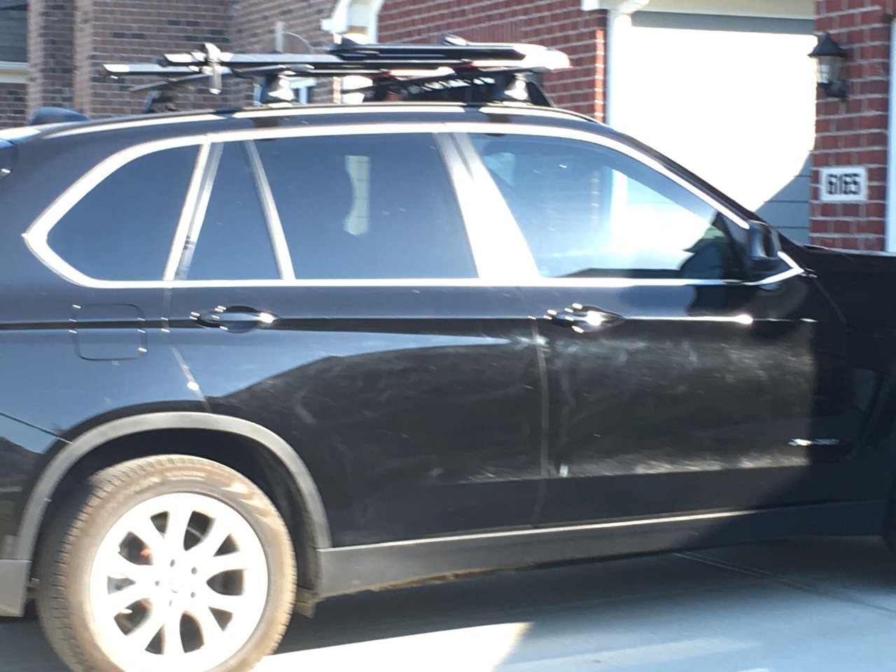

    This is marring:
    And just to play semantics. If the paint damage is caused by machine its typically referred to as holograming. Marring can be done by hand or machine but hollograming is only done by machine.
    The above picture is marring by hand. Bless their heart.
    Hologramming by machine is typically more aggressive. Its not itty bitty swirls like your photo.
