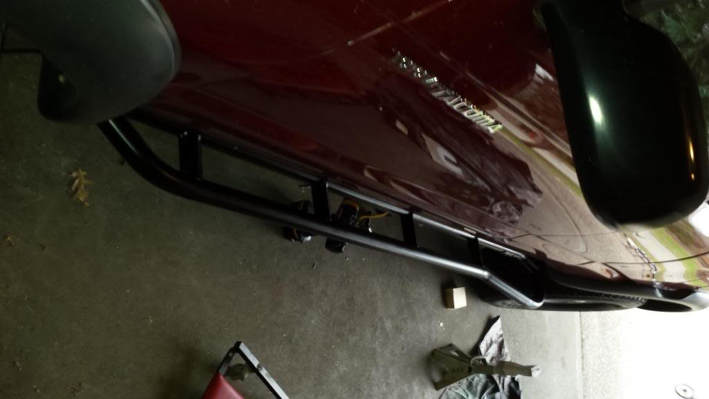

    Brute force wins again with a little help with an impact wrench. Complete with "high quality" cell phone pic

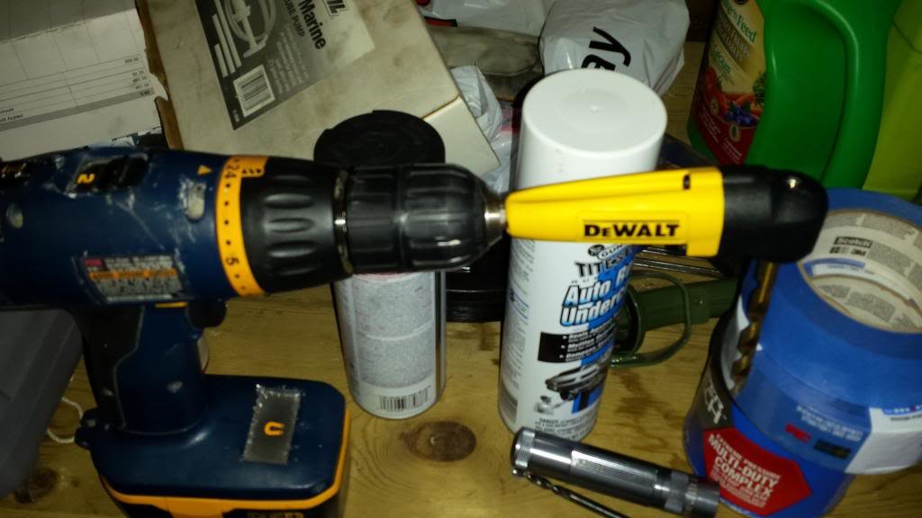

    Learn from my mistakes and get a right angle drill if you are bolting sliders on. If you don't have one and/or don't want to spend $100+ on one, get something like shown in the pic for less than $20. Its a right angle adapter that fits on any drill.
    Holy heck life just got easier using this thing. It fits perfectly between the frame, sliders and pinch weld giving you access to all of the mounting holes. I would have been done yesterday with zero screw ups if I had used this thing.

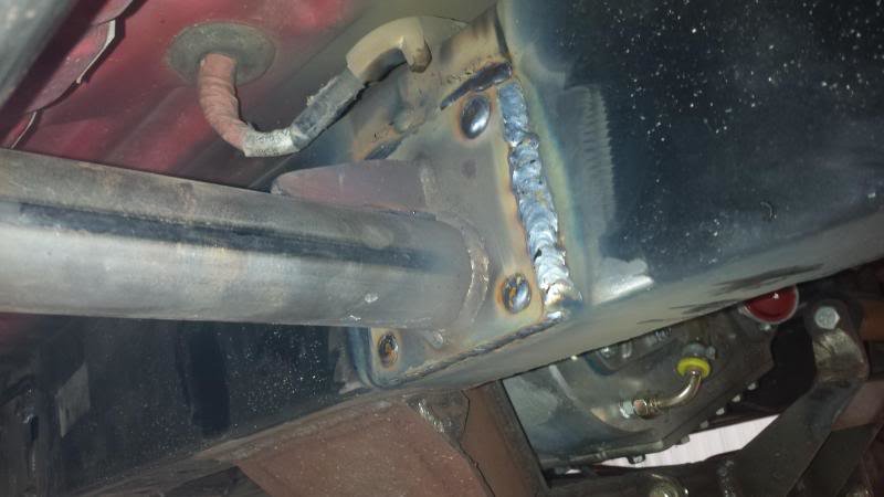

    quick question, it might be different because of the fully boxed frame but it was my understanding that your not supposed to weld up and down on a frame but only front to back because of structural strength? about to install these sliders on my toyota and not sure.

    ^If you are going to weld, weld around the entire perimeter of the flange. Otherwise you risk breaking off the slider when the truck's weight is on it. It's a bigger risk than weakening the frame.

    I am not too worried about the frame being weaker in that spot. I am sure the frame is plenty strong even with the slight heat effected zone that runs up and down the frame tube in that spot. You should see all the welding I did on the frame to weld up the new cross member for the SAS and the new frame I built up front.

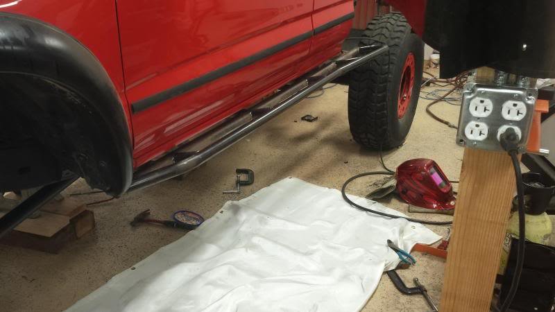

    gotta keep the new Epoxy floor nice at least for a little while :). Its a welding blanket. Keeps me from making little burn marks in the floor. :)
