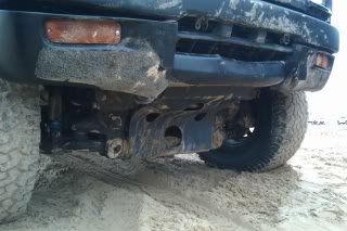

    Anyways... last week ago I smashed my radiator pretty bad :eek:
    everything is fix now but my steering wheel feels funny when im turning to the right only. Got under the truck to see the steering rack and told my dad to move the steering wheel while i checked under the truck and i notice a bolt was loose.
    http://www.flickr.com/photos/wafflekiller/5566066786/
    Is that normal? Does it need to be tighten?

    Nope, just get a set of steering rack bushings. I think Wheelers or Toytec has the.

    It won't hurt to try but I bet it is tight. What you see is the rubber bushing is worn causing the rack the move.

    Don't think it'll do any good until you get new bushings. Just make sure it won't back all the way out by then.

    The bolt isn't loose, there's a steel sleeve thru the bushing and chances are it's still tight. The bushing is bad. Tightening the bolt at this point is pointless. Buy the good bushings from Wheeler's, install them and THEN tighten the bolt....
