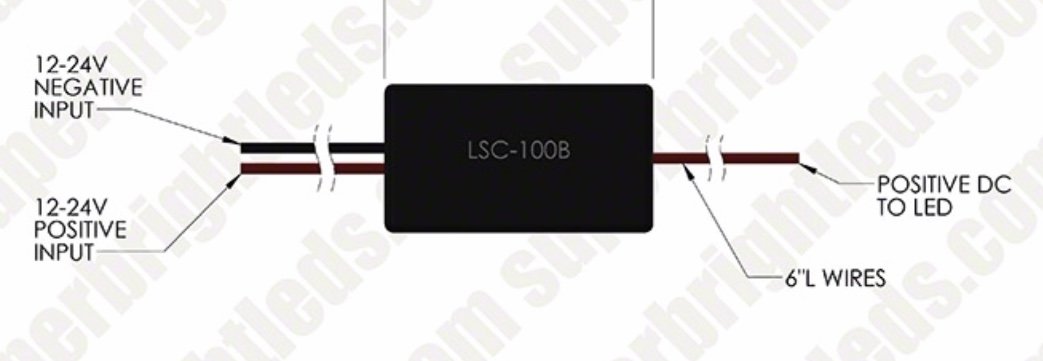

    Looks like it had a 3rd brake flasher. The white wire was tapped for negative, and the purple wire was cut to provide the positive input and output.

    I don’t have tailgate lock or bed lights.
    The purple wire actually powers the brake lights, as I found out. So it’s mostl likely the breaks flasher relay or whatever

    So is this a common place for the flasher module to be installed by the dealer? My 3rd brake light flashes and I hate it. Bought the truck as a CPO and didn’t realize this was installed until my wife was following me a few days later. I was going to wait until my first service and have them remove it but since it sounds like easy removal, I can do it myself. I tried searching on here but came up empty. Only found info in the 4Runner forum and it said drop the headliner.

    Answered my own question when I got home from work. Sure enough. Simple fix to remove that POS. Looks like I’ve got a 2 minute project this weekend.

    Wow that looks identical to what I have. I just don’t have the actual module. The T tap and bullet splice

    I found the same connection inside my center console when I tore my truck apart for sound deadening. Definitely looked non-factory. I assume the dealer did it since I bought my truck new.
