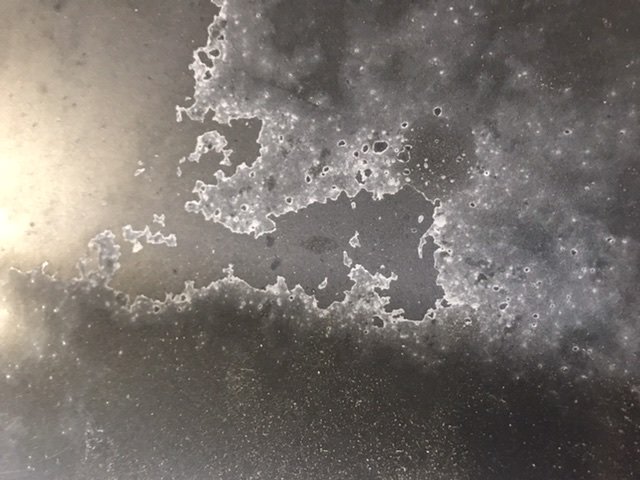

    Hi all,
    My clear coat is pretty faded, and I was considering sanding it off with 1000-2000 and reapplying a clearcoat.
    From reading here, I understand that this is a temporary fix, it will not match perfectly, and the paint is already faded. That’s alright, I mainly want to get rid of the white outline all over my hood.
    With the right prepwork, is this feasible over such a large area? Or should I save my time and wait for a complete hood repaint?

    I cancelled the paint order, but i'd at least like to protect the remaining paint on the hood and maybe get some of that white residue off. Here's my plan, please critique!
    1. Wash hood
    2. Use CLR and 1000 or 2000 grit sandpaper on the white residue.
    3. Use 2000 grit on hood (area with exposed paint) to rough up the surface
    4. Find some clearcoat in a can at autozone or walmart; Put two coats on the area of the hood that I roughed up.
    I'm not too concerned about looking perfect, but i'm not trying to shotgun it either

    Use Spraymax 2k clear. It has a 24 hour pot life. Read and follow the tech sheet and you’ll get a decent finish.

    You're going to find it extremely difficult to just sand off the clear coat. What this will lead to is you breaking through the basecoat and into the primer. Translation: An ugly situation is just going to get uglier.
    As for using Fluid Film on a hood, absolutely not! If you do, the first rain storm will turn your whole truck - and especially your windshield - into an oily mess. And as much as I love FF in the proper application (which this is not), it smells awful.

    Thanks for all the replies guys. So here’s what I did so far: I tried to sand off the clear coat before I read the advice, and it didn’t work at all!
    The paints already destroyed, so I used a metal paint scraper to get the clearcoat off. I only removed the fading/white CC and left the good stuff.
    After that, I used some duplicolor CC (didn’t see the spraymax post). I used 3 light coats and 1 heavy. It’s still drying.
    Hopefully that white residue crap won’t come back for at least the next year! Will post pics today, of course

    Before, white pealing CC everywhere:
    After. No white CC. Just faded paint from years of sun with no clear coat to protect. And...a few spots where I tried to sand! Whoops
