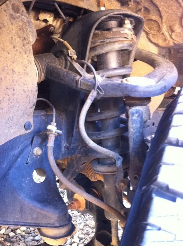

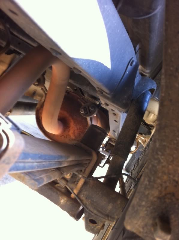

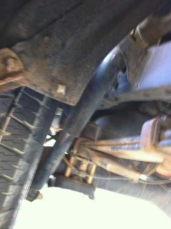

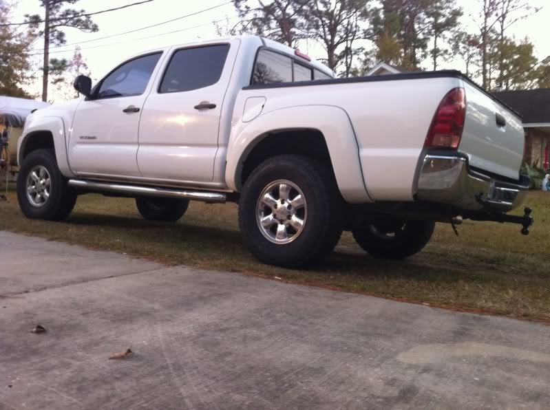

    The rear seems high to me for it to be stock and there are spacers on the front. I have 5100's coming in today for the front and the rear. I plan to do the rear myself and take it in for the front. I don't plan on doing aal so trying to figure out where to set the 5100's. right now the front is about 1/2" higher than the rear from the ground to the top of the finder with the spacers I don't know what the lift is on the spacers. I don't want the front to be higher if anything a little lower than rear.
    this is how it sits

    it looks like only 3 leaf springs to me, so i would say its stock but its hard to see

    Looks like 4 to me? Stock with an AAL?
    Or is that just a pad between the leafs and the overload?

    looks like upside down aal lol

    figures, This is one down fall to buying used. getting frustrated with what is suppose to be my new truck. lol so now what? flip the small pad thing over following the instructions like i was going to be installing a AAL.

    in the first pick, i looks like it might only be 5-7in or so, looks like just a pad..no aal is that short...is it metal?

    Looks to me from top to bottom...
    2 leaf's, a rubber pad, then overload spring?
    edit: If that's not a rubber pad and is in fact a aal it looks upsidedown like mentioned earlier.

    Just went and check, it's rubber.

    +2, looks like 3 leaf crap pack that is sagging with some kind of pad crammed in there. Mine looked similar to this minus the pad before adding the AALs. No TSB for me either since it was used and past 36k. Just get some AALs. Mine has been fine with AALs. Much more like it should have been.......except they all should have had the 4 leaf packs to begin with.

    5100's come in today. taking the spacer crap off the front and putting them on. I was trying to figure out if the back was raised are not to see how high to set the 5100's to lvl or nose slightly lower.

    Yep...the front is higher due to the rear sagging. I got a 2" aal in back and raised the front 2" and have a 1" rake (the back sits higher than the front with the weight of a canopy.)
