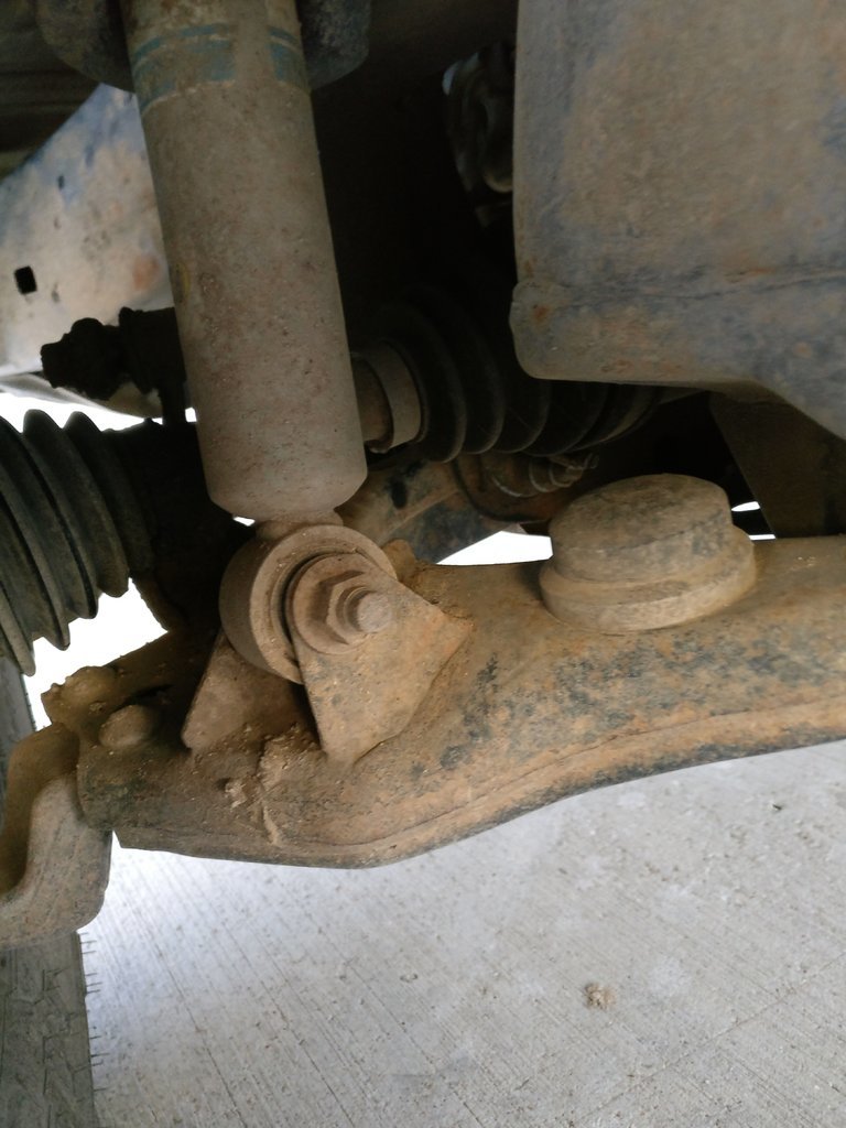

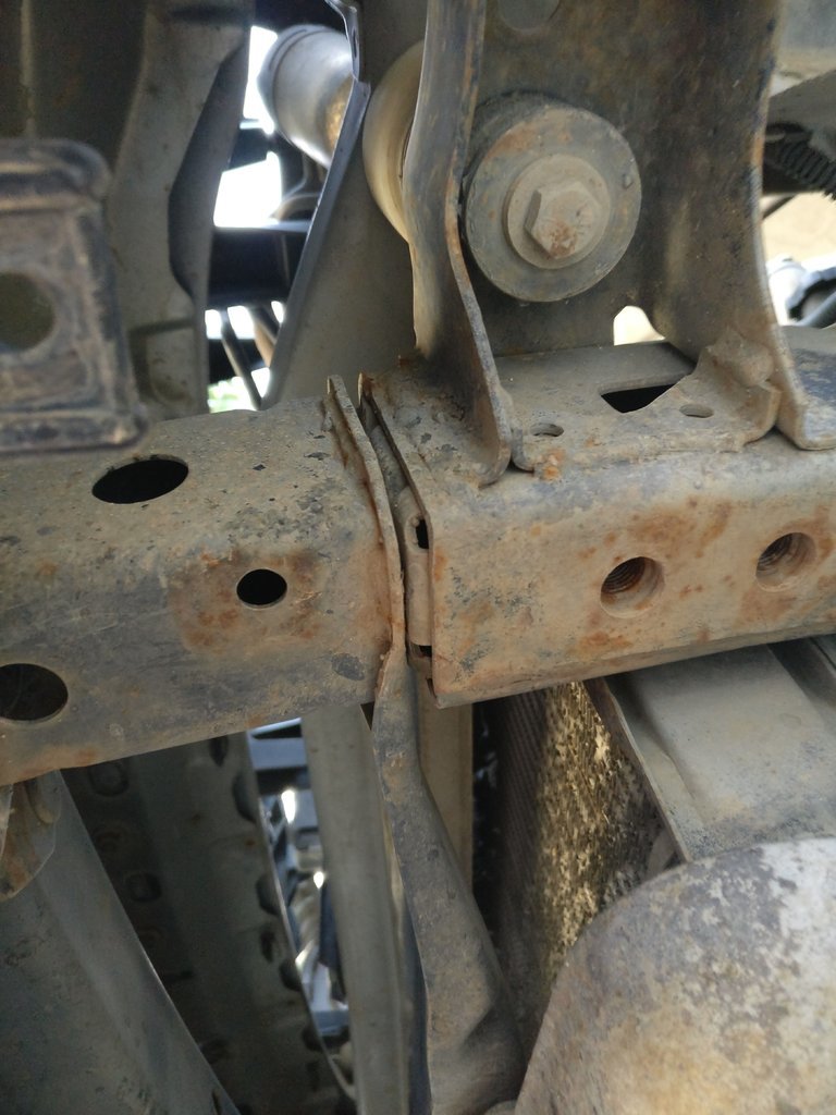

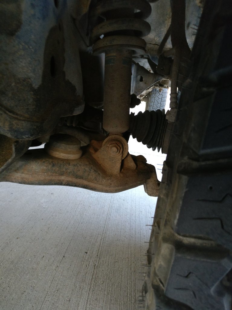

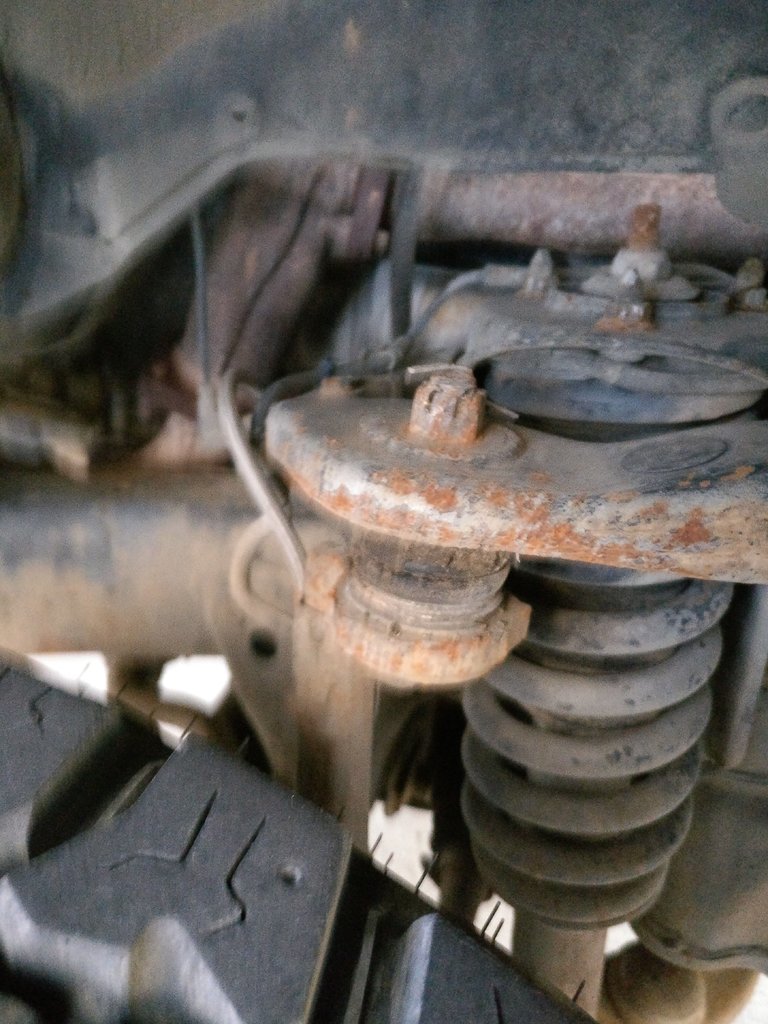

    Bought this truck recently and noticed some rust on the underside. These are a few pictures I took of the underside while inspecting the front end for squeaks. It seems to be surface rust but I wanted a second opinion. Could I hit it with a wire brush to slow it down?
    On another note if anyone has some advice on how to remedy the squeaky front end I would appreciate it. Only squeaks when going over speed bumps.

    I wouldnt worry about that.

    Looks like some paint would help out - the area around the ball joint looks nasty - gunked up

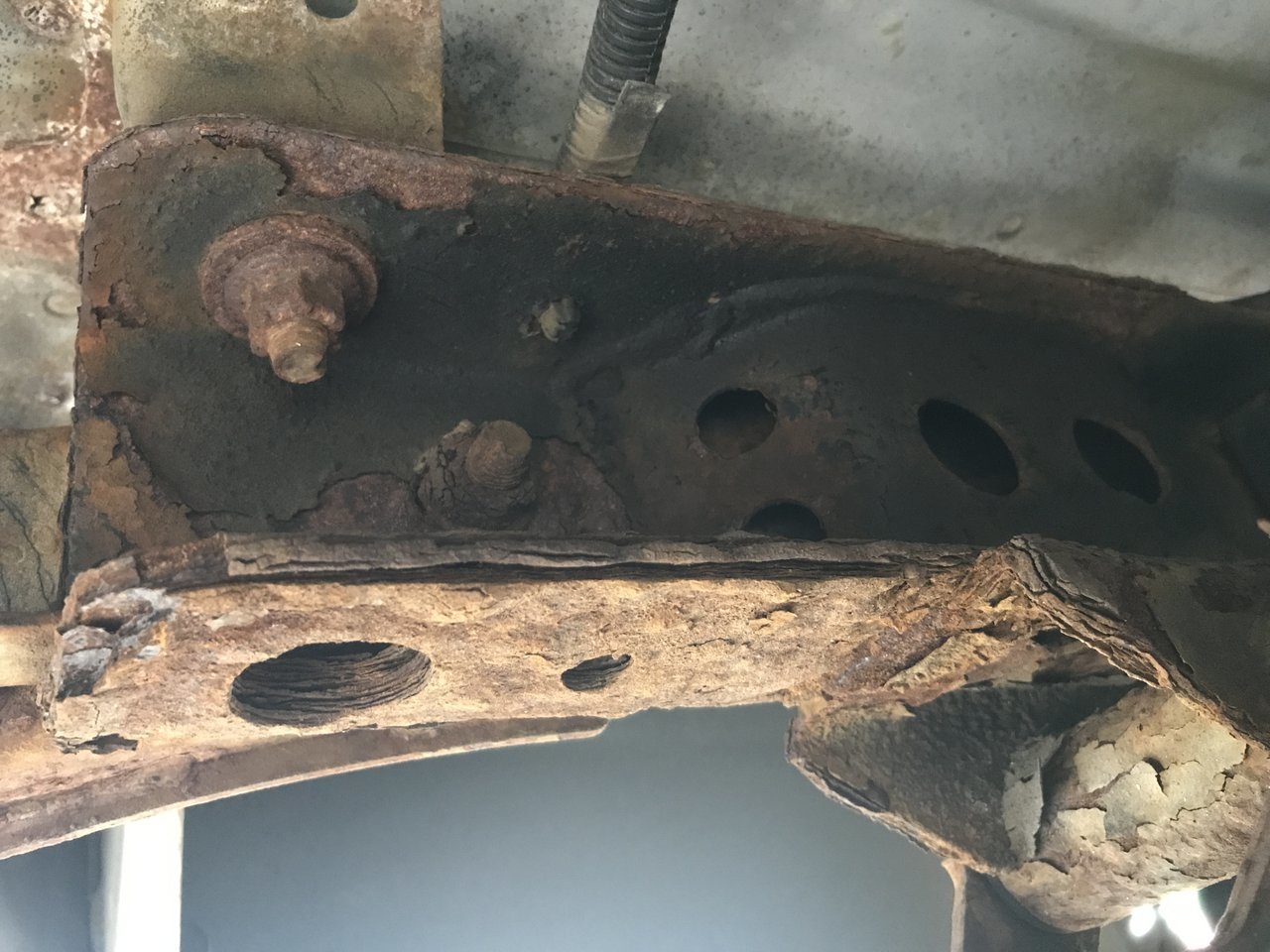

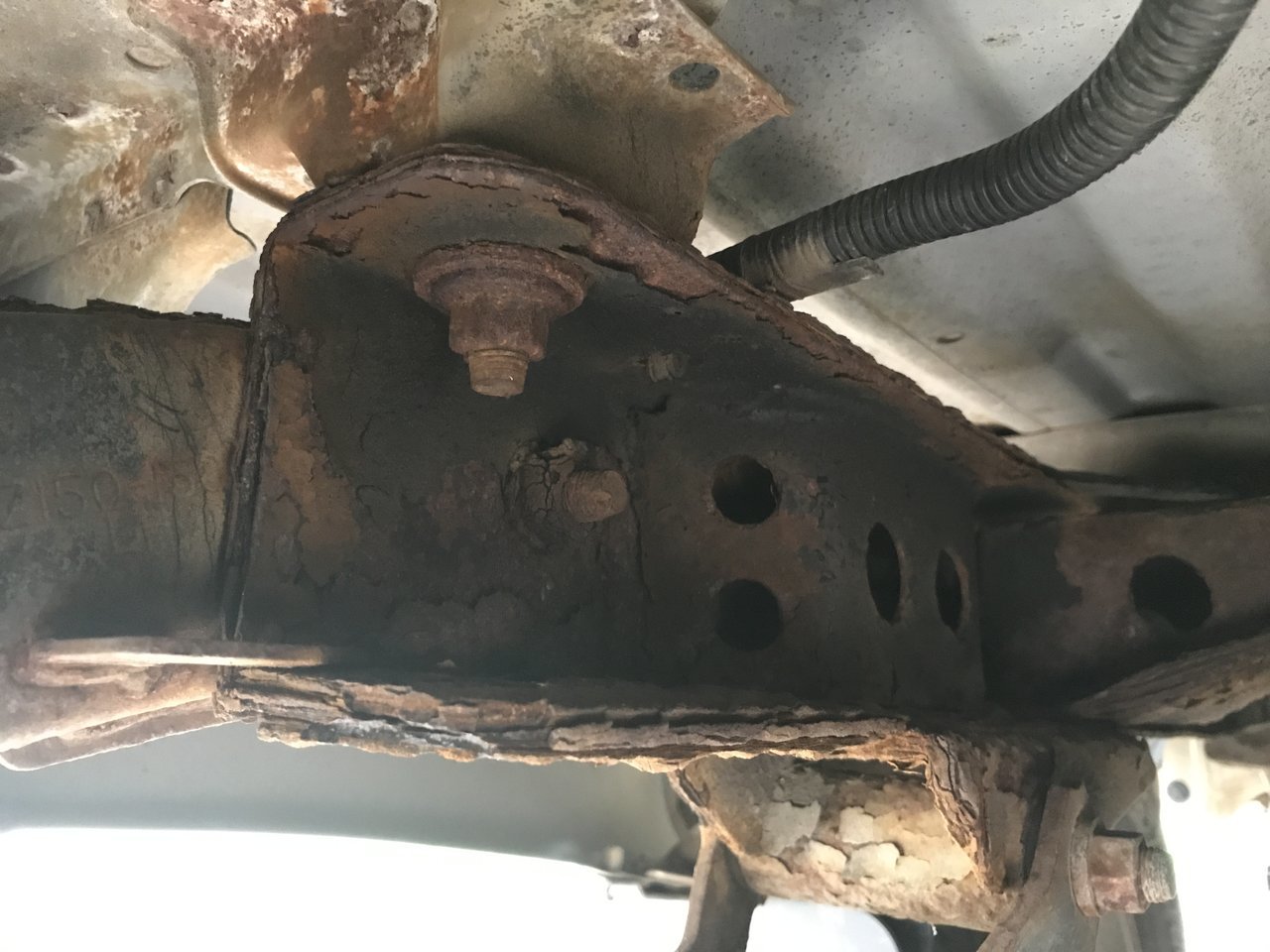

    These were taken today of my truck I just picked up. I going to see if toyota can do anything for me. Yours is just typical surface rust

    My lord man​

    Squeaking is typically a bushing so check those for cracks and/or damage.

    Yea thats what I thought. the rest of the frame is surprisingly good though which is crazy.

    Would applying grease to these bushings help? or would they need replacing if there are a few cracks? Look like most of the bottom has some dry rot areas on the bushings.

    Not bad at all.
    Actually wire brushing it will remove it, but won't stop it nor slow it down. Grease is what you need. It will prevent rust from progressing and coming back
    if you want to paint it, remove as much loose rust as possible and be sure to use a rust killer/converter before applying the paint, as painting over rust doesn't stop it. Then grease your frame

    yes, wire brush the surface rust, then rust killer/converter, then POR15.
    As I said, painting over rust doesn't stop it. It hides it, but rust keeps progressing and worsening under the paint, unseen to the eye, untill the paint peels off or bubbles and you have to remove it all and start all over again.. Or worse, untill holes appear in your frame...

    Wire brush it good. Then if you want it to look pretty POR15... then later on Fluid film it to really protect it.
    Or just wire brush and FF it. Done. It will stop any more rust. Reapply it once a year. As a bonus it keeps excess mud and dirt from sticking though some dust will naturally coat the FF.

    Sorry, but that kind of thinking gets all these trucks rust the frame to shit.
    @Dangorah yes, worry about it and take some action now, before few years from now you will start "another frame rust" thread. You can take care of that rust (meaning stop it from progressing) with few cans of fluid film for example. Keep in mind the rust will not go away nor will stop on its own. Preventive maintenance is required in "rust subject" for these trucks.
    By the way fluid film is also good for removing squeaking of rusted parts rubbing at each other. Can't go wrong with fluid film. 50 bucks invested in 5 cans from Lowes ($10 Fluid Film 1-oz Lanolin-Based Petroleum Oil AS11https://www.lowes.com/pd/Fluid-Film...osion-Preventive-Penetrant-Lubricant/50335157) will pay out in long run.
