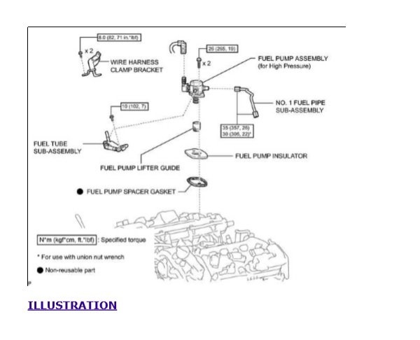

  14. Jul 4, 2016 at 8:47 PM
    splitbolt
    splitbolt Voodoo Witch Doctor
    Mar 7, 2010
    #32761
    7,858
    NW Arkansas
    2016 TRD OFFROAD DCSB MGM
    Sounds like the lifter in the pump clacking around; it runs off a cam.

  16. Jul 5, 2016 at 6:12 AM
    #16
    splitbolt
    Mar 7, 2010
    #32761
    7,858
    NW Arkansas
    There's been a few high pressure pumps replaced; those made a chirpy sound though.
    Let us know what they find, and good luck.

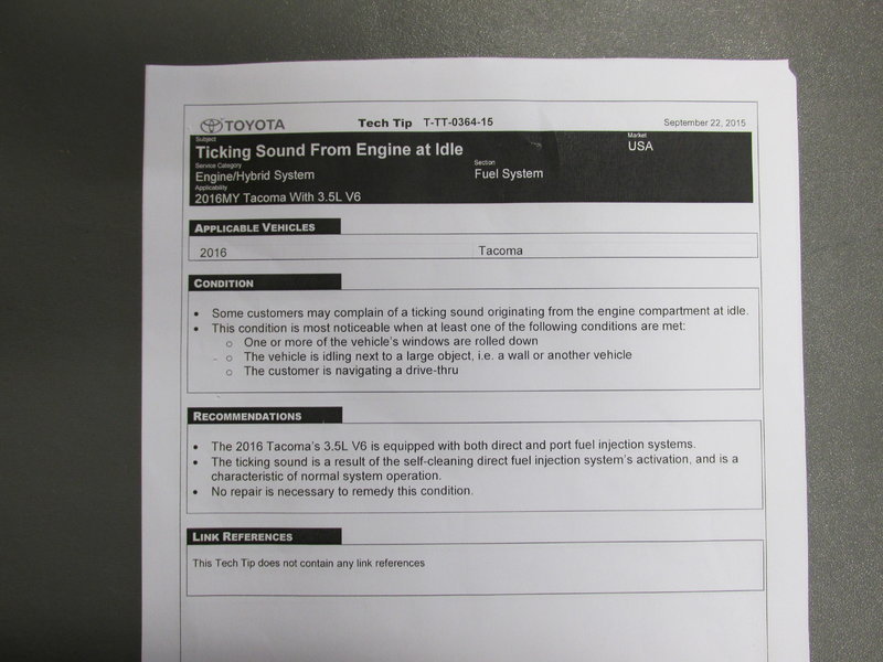

  17. Jul 5, 2016 at 8:01 AM
    #17
    '16TacomaTRD
    '16TacomaTRD Well-Known Member
    Jun 13, 2016
    #189480
    442
    2016 White Tacoma TRD Sport w/ premium tech & JBL package
    The 2016 Tacoma's 3.5L engine is equipped with both direct and port fuel injection system. The ticking sound is a result of the self-cleaning direct fuel injection systems activation and is a normal characteristic of normal system operation. No repair is necessary to remedy this condition. (I found this online because I was wondering about mine also!)
    slamson00 likes this.

  19. Jul 5, 2016 at 11:21 AM
    #19
    Kemosabe1946
    Kemosabe1946 Member
    Oct 31, 2015
    #168243
    15
    2016 DCSB TRD Sport
    This is what Toyota claims is causing the tick noise. Can't say that I agree with this analysis as, as this forum will attest, the noise is only on the right side of the engine so, if its due to injector cleaning it would be on both sides of the engine. It is inconceivable to me that Toyota would bring a product to market with a noisy engine, especially the long awaited redesigned Taco with the new Atkinson Cycle engine. I'm not buying it...file this under unmitigated bullshit...TacomaTick 008.jpg
    specter208 likes this.
