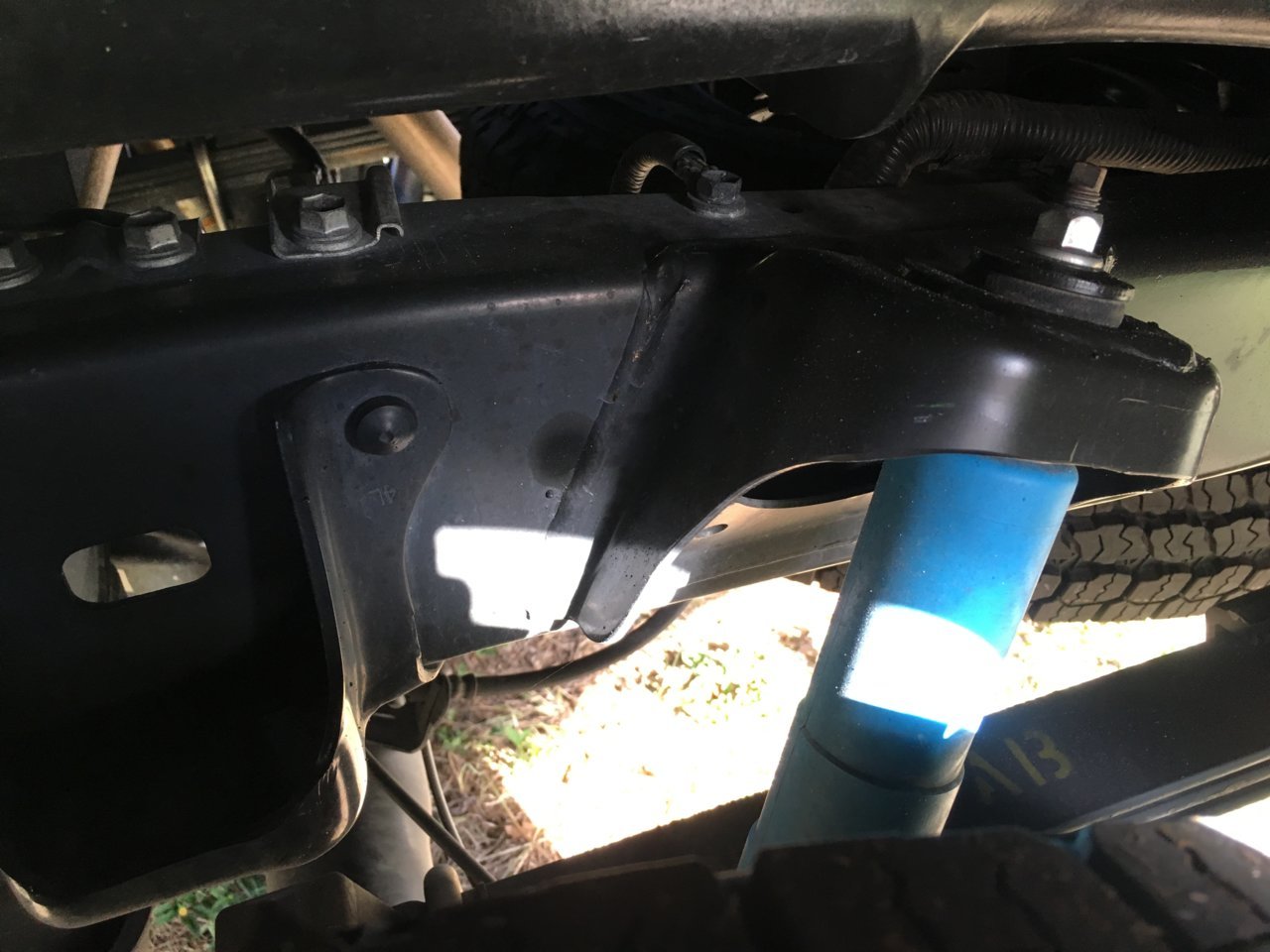

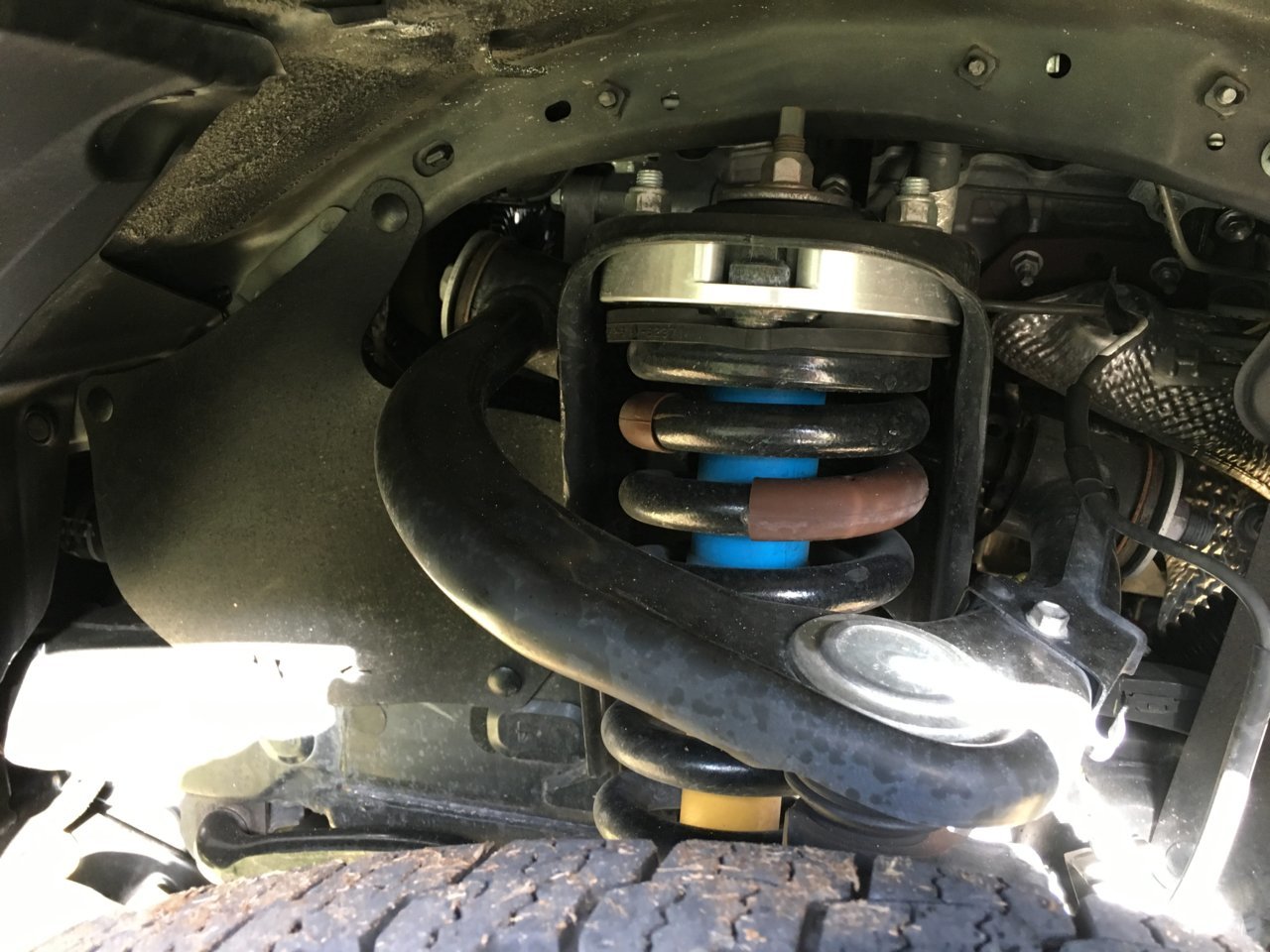

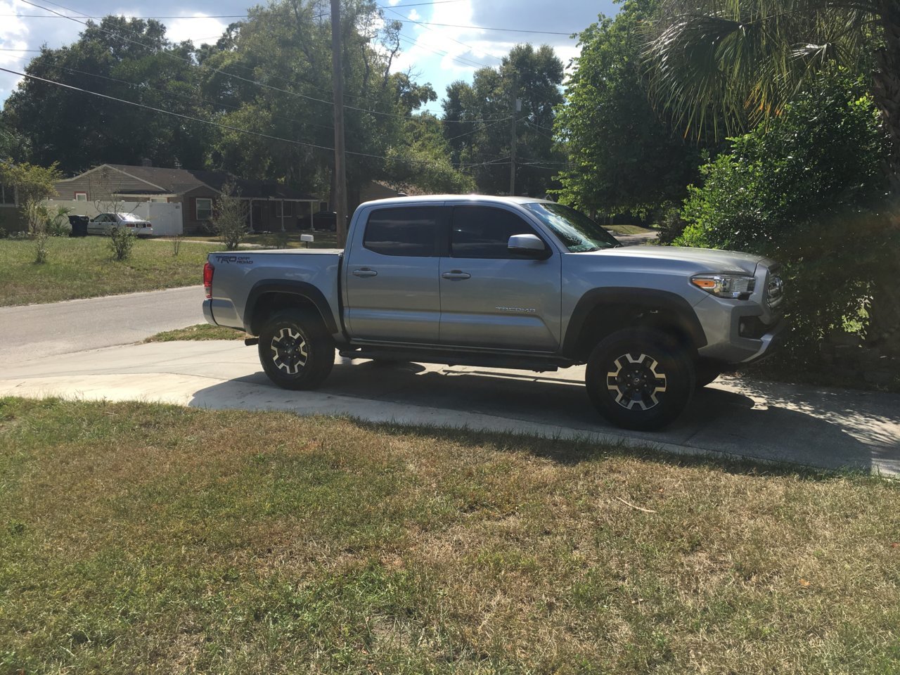

    last weekend I bought a 2017 OR Tacoma. It's in great shape but I am starting to feel like some modifications were done that I wasn't aware of. The truck appeared to have the front end higher than the back end. I don't know a ton about Tacomas yet but it appears I might have a lift in the front but not the rear? Please help me figure out what's going on here. If this is the case how easy is it for me to have this removed? Vehicle is for work so I don't really need or want it lifted especially only in the front.

    That silver puck above your strut is a leveling spacer.

    What does that generally imply? And why would that be there?

    It’s meant to lift the front of the vehicle for aesthetics- it levels the truck front to back. Most pickups have a little rake to them where the rear is higher than the front which accommodates any type of load in the bed of the truck.

    I agree. "Leveling" almost always creates a little bit of bro-lean which is horrible looking IMHO

    I think all you need is an add-a-leaf in the back. Cheap and it will look great IMHO
    I think you likely have a lift AND spacer on the front. I don't think a spacer in back will do anything.

    Bro-lean refers to the front being higher than the rear. People "level" the front to supposedly make it equal with the rear. They're almost always in denial, because it always looks higher in the front than the rear.
