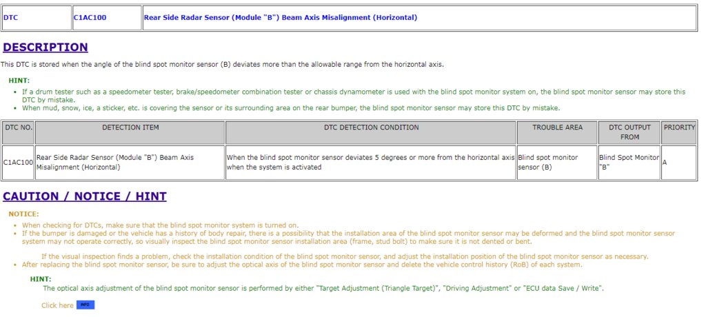

    I've not messed with the BSM, but I have messed with various aftermarket mods to the forward sensor. And I can say that on that one at least, it can tolerate vinyl, BUT it needs to be perfect. A single air bubble, speck of trapped dust, or any layer thickness imperfection: it will "see" the difference and get confused by it. Its basically the equivalent of putting on dark sunglasses versus putting on dark sunglasses with a single scratch. Now all you see is the scratch and you'll throw an error code over it.
    I'm betting the BSM array will be similar. I would not mess with covers unless I was confident that my color wrapping job could be done with absolute perfection.

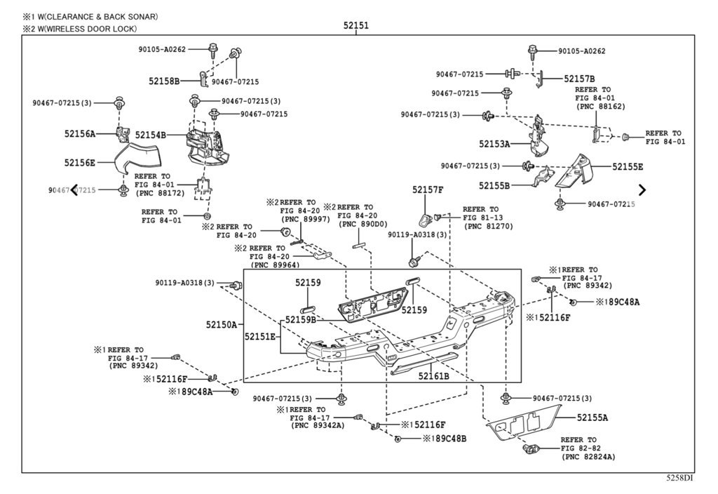

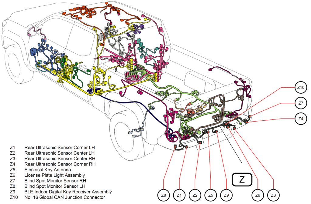

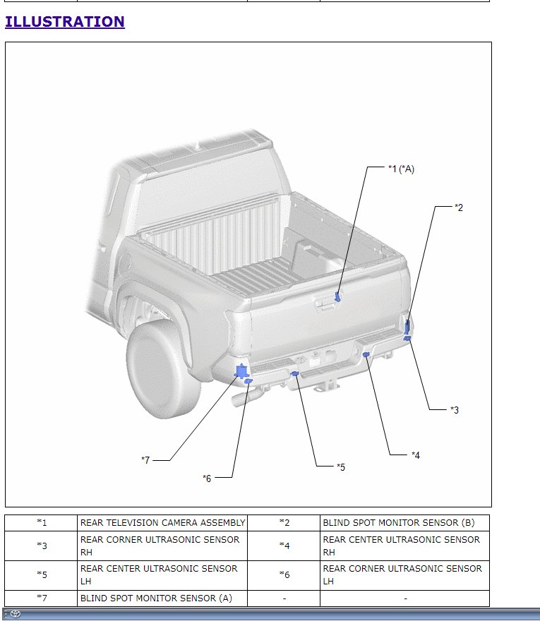

    :smack:The "circled" item is what the OP is asking.
    The Blind Spot Monitor System sensor is indeed behind it.
    One can see the Ultrasonic sensor clearly, part of the Parking Support Alert System & Parking Support Brake System.

    Where do all of these fancy illustrations come from? I'd buy this book
    Also, one might try to put a sticker on it to see how it reacts? If no problem, then wrap away!
    I doubt painting it would leave any air bubbles...

  20. Sep 4, 2024 at 3:08 PM
    #20
    Dm93
    Dm93 Test Don't Guess
    Mar 3, 2015
    #150066
    13,384
    Texas
    2014 DC OR 6spd 4x4
    Predator tube steps, Ranch Hand grill guard, Magnaflow CatBack exhaust, Toyota tool box & bed mat, 2LO Module by @Up2NoGood, Rearview Compass/Temp Mirror, Tune by @JustDSM.
    You need a TIS subscription.
    techinfo.toyota.com
