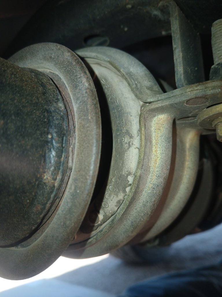

    Good evening, everyone. My OE CB is on its way out, so I did a search for the correct part number. Google gave me this site. The price seems OK. Same part number. I understand that there seem to be two different carrier bearings available, depending on if it is for a 2wd or 4wd application. Some models don't have shaft seals. This one looks to be identical to my OE unit. Just looking for some feedback. Thanks!!

    I searched far and wide for a carrier bearing with a seal. When dropping off the shaft to the driveline shop he was disappointed I got the one with the seal. He said he always installs the one without the seal since it does not add heat to the bearing.
    It's mostly dry here so I am not concerned about a seal in front of an already sealed bearing, but he installed what I brought. Next time I will get the other one.

    Exactly, spicer was OEM, why pay dealer prices when you can ger dealer parts for cheaper?
    If you want to dig into Tier 1 parts vs Tier 2 parts i agree. What is availiable aftermarket is likely the same now.

    So is the link in the first post the one I should go with? OEM around $102

    I'd buy it from rockauto... but yeah
    Edit: you live in Arizona, where they don’t ship. Bummer

    Okay, so I just bought an OEM unit from Summit. Exact same part number as mine.
    Spicer 5002007/Toyota 37235 35030.
    It was around $116 out the door with free shipping. It seemed like the best deal. Hopefully she'll be good for another 200k. I'll keep this thread updated.
