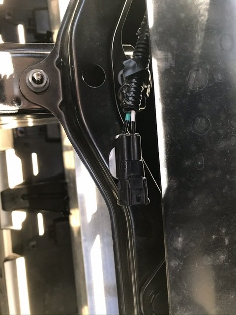

Is this the fog light plug ?

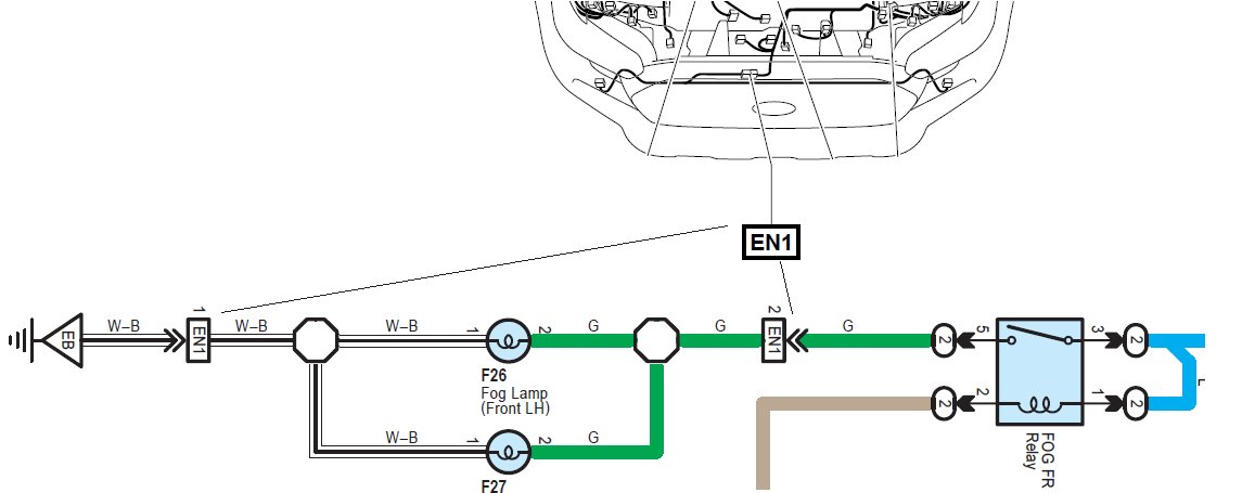

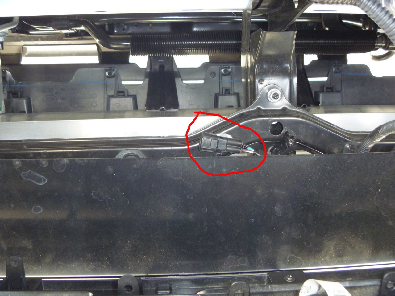

  2. Jan 14, 2020 at 3:14 PM

    I'm surprised it doesn't have a plug to cover the contacts...

    It will have shortly.

    Got the harness ordered, stalk assembly replaced. All I need now is the relay and the lights themselves. Haven't decided yet which ones I want. Any tips and/or recommendations much appreciated.

    Mine is pre wired so I'm assuming I can end up with a factory install with everything working like it does on one that came from the factory with them. Just need to sort out whether I need to go OEM or if after market makes more sense. Thinking maybe going with the bogus Rigids from Alibaba.

    As I recall, I had to buy the harnass that ran to the fogs. It plugged into a plug that was already installed in the truck. It was located about centered in front of the radiator. Think I also had to buy a relay. They worked flawlessly and have ever since including the light on the dash. I was lucky to find the full stalk assembly on eBay. If I hadn't I would not have bothered with the fogs, but as it turned out I go both the fogs and intermittent wipers. I got the fog light assemblies including bulbs from member here. They're OEM. Might upgrade sometime in the future.

    I saw that plug in my truck, but didn't have the stalk. I expected the power box (under the hood) would not be complete (as in no relay, no fuse, no wires, etc.) so I didn't go that route.
    But now it is nice to know that I can use that existing harness (for something else) with very little other work. Light bar maybe. Of course I'd have to reconfigure a switch in there since I still don't have the stalk.
